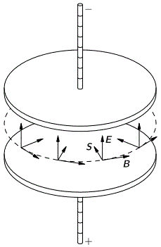

Picture a charging capactor, you know the E field, and the induced B field, the energy flow is just EXB.
Please describe for me in rough terms the energy flow vector field near and far from the slowly charging capacitor? The flow of energy must ultimately come from the source of energy that charges the capacitor, say a battery? Has anyone ever seen an image of such a flow of energy for this system? Can you roughly sketch what it should look like? Do you simply draw lines of S from the battery to the entrance of the gap of the capacitor? Let the only resistance of the circuit be the internal resistance of the battery. Feynman goes into this here,
http://www.feynmanlectures.caltech.edu/II_27.html
Thanks!
Edit, where in space and time can one safely say that the field S should be zero?

I have not thought deeply about this, but feel that the answer may lie in thinking of the circuit as a fully 3D object.
Between the capacitor plates, sure that's where E and B are pointing, but outside the plates you have a fringing field and E has a radial component, which must mean S must have an axial component (the axis of the cylindrical capacitor plates in the diagram). That's a good starting point to retracing the origin of the vector.
There is another subtlety here. You said "slowly" charge the capacitor. This implies a quasi-static approximation where higher order field effects (e.g. secondary E and B fields). In this approximation I don't expect any far field energy flow, since far field energy flow would be radiative (which requires the secondary and higher field effects). Maybe I misunderstood this part...

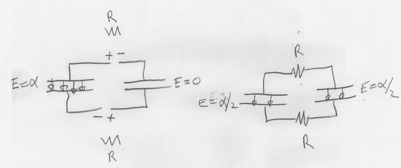

So there will be loses. I am still interested in the flow from the source to the sink. Consider the following specific example,
We initially have a charged and a uncharged capacitor with wires that nearly touch. Then we span the two gaps with two resistors R. Energy will flow from one capacitor to the other and energy will also flow to infinity. If we were to carefully account for the electric and magnetic fields should we be able to plot power flow to and from the capacitors and also the power flow towards infinity?
