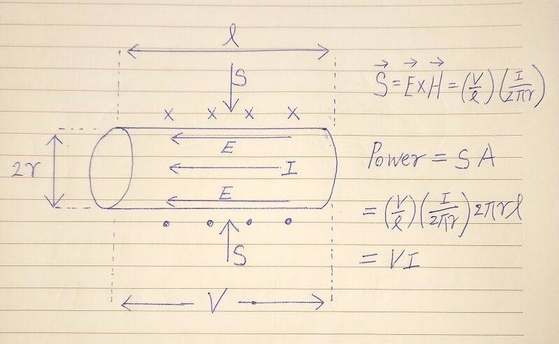

This discussion thread has a very in-depth discussion of energy flow in wires and extends to other rich content. Please excuse me for not having time to read every reply post.
Below I try to analyze the simplest conductor segment using Poynting vector. The results show that the real energy flow enters from the outer space vertically through the conductor surface and remains in the same direction until the the conductor center. The energy flux on the conductor surface is exactly equal to voltage multiplied by current (ohmic losses). But I really don't understand and suspect that there is an internal energy flow inside the conductor in a different direction than the Poynting vector?
Note that this is not a waveguide that assumes no ohmic losses inside the conductor​

Hello Alan123hk. Yes, you have apparently missed some important posts. I tried to give the idea in the doc I posted in post #176 (that I somewhat abusively called "article"). Please, have a look there. Also, you may want to have a look at the historical account about this old debate in articles posted in posts #188 (and also #177).

You should read the thread more in details, my last PDF for example. Otherwise the thread will grow over and over just repeating the same things over and over.
1) Poynting vector is not the whole energy flux. A quick way to see this is to compute ##\nabla \cdot \vec S##. In steady state, the divergence of the energy flux must vanish, everywhere in the wire. However, if you do that with the Poynting vector, you will get that it doesn't vanish, in fact it will be equal to the Joule heat. This is a clear indication that the Poynting vector is not the whole energy flux in the wire.
2) I have shown that if the conductor has a non zero resistivity, then it cannot be isothermal when there is a current going through it. This has an implication, that its center is hotter than its surface. The thermal energy flux, which is given by Fourier's law (##\vec J_Q =-\kappa \nabla T##) points radially outwards the wire. This is true for any point inside the wire.
3) Yes. From the thermodynamics relation ##dU = TdS+\overline{\mu}dN##, one can see that there is an energy flux component that goes in the direction of the current. In the case of the wire, this means along it, i.e. perpendicular to Poynting's vector.
