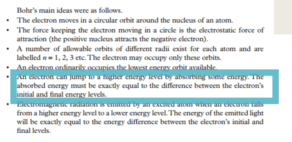

It means that the textbook that used that word was being sloppy. (Btw, you haven't referenced any specific textbooks; can you actually find one that uses the word "exactly" in this context?)
This is the passage from Australian Curriculum Pearson Physics 12, NSW ed (high school textbook). This is what made me finally ask this question, but I was just paraphrasing the sort of explanation I feel like I usually see.
Please keep in mind that I would never read anything with heavy maths.
Thank you so much for the answers guys, and I really appreciate the links (PeterDonis and Perok). I'll keep these on hand for future reference.
Some of it is going over my head atm, but I'll have another go reading it later.
Obviously you need a good mathematical knowledge to understand this stuff, and it is something I'd like to teach myself sometime in the future, but certainly not near there yet.
Appreciate it all
Nathan.
This passage is describing "Bohr's main ideas". That's not necessarily the same as our best current understanding of QM today. In Bohr's "old quantum theory" model there was no broadening of spectral lines.
