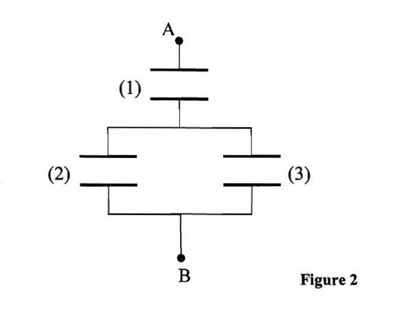

The above is a capacitor system. A dielectric is inserted into capacitor C3 and I need to find the total energy of the system. The dielectric is not fully in, only partially (lets say a length x).
I first found the capacitance of C3 with the dielectric partially inserted. I know that dielectric makes a system of 2 parallel capacitors.
Hence
[tex]C3 = \frac{L\epsilon_{0}}{d} (x(\epsilon_{r}-1) + L)[/tex]
where L is the length and width of the parallel capacitor.
Total capacitance of the system = [tex]\frac{(C3 + C2)C1}{C3 + C2 + C1}[/tex]
To find the total energy, I use the formula [tex]1/2 \times \frac{Q^{2}}{C}[/tex]
which becomes:
[tex]1/2 Q^{2} \times \frac{C3 + C2 + C1}{(C3 + C2)C1}[/tex]
Does this seem correct? The answer give to me by the professor is:
[tex]U =1/2 \frac{Q^{2}}{C1} + \frac{Q^{2}}{C2 + C3}[/tex]
I'm just kinda whether I'm wrong or the prof is...
Please advise.

erm :redface: … they're the same! (assuming the professor's "1/2" is for both bits) :smile:
Really? Could please show me how? I really can't understand how they are equal!
Do we use Partial fractions to expand the fractions or am I way off?
1/C1 = (C2 + C3)/(C2 + C3)C1
1/(C2 + C3) = C1/(C2 + C3)C1 :wink:
(generally, 1/a + 1/b = (a + b)/ab )
