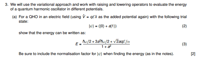

For a quantum harmonic oscillator in an electric field, using ##\hat{V}=q\epsilon\hat{x}##, with the following trial state: $$|\psi\rangle=|0\rangle+b|1\rangle$$
Show that the energy can be written as $$E=\frac{\frac{\hbar \omega}{2}+\frac{3b^2\hbar\omega}{2}+\frac{\sqrt{2}bq\epsilon}{\alpha}}{1+b^2}$$

Hi, yes I am sure I have copied it correctly, here is a snapshot of the question. Please note I have swapped the a with b, to avoid any confusion.
Maybe it is assumed that a is real?
Yeah, it seems like the question maker forgot to state that ##a## is real, otherwise the minimization problem cannot be carried out with only one equation because a complex number consists of two real numbers.

The only small mistake lies in your calculation of the unperturbed "energy". Note that the trial function is a superposition state, therefore you cannot associate any energy eigenvalue to it. What you can do is to calculate the expectation value of energy. This is the reason why you got only ##b## in the 2nd term of ##E_{\psi}^{(0)}## instead of ##b^2## as it should be. Once you correct this and take normalization into account, you should be able to prove what is asked.
Thanks for the help blue leaf! I was able to prove the statement.
