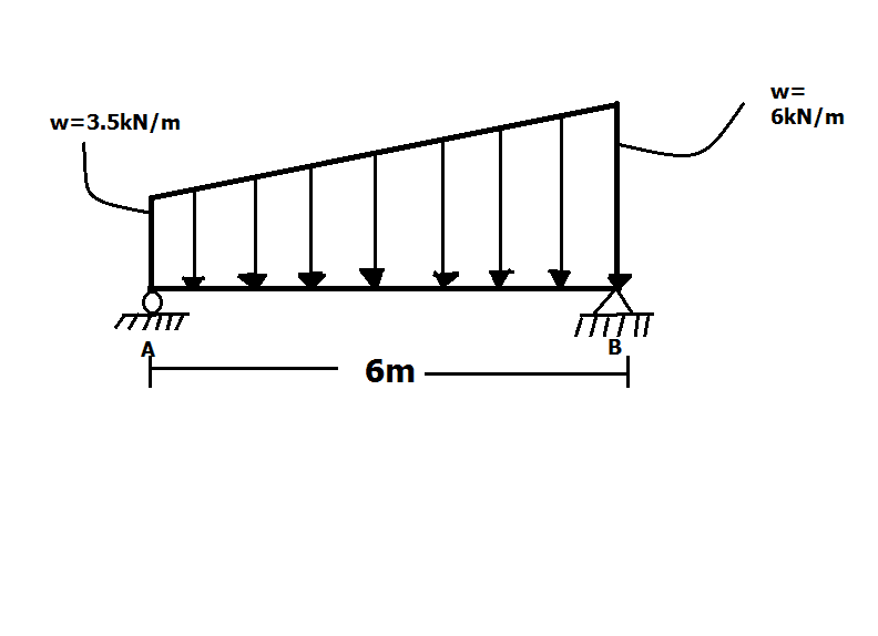

1) Solve for shear and moment at the given distances
a) at midspan
b) 5m from ROLLER "A"
Simply supported beam 6 m long with a roller support at A on the left and a pin support at B on the right, carrying a linearly varying downward load from 3.5 kN/m at A to 6 kN/m at B.
SO FAR I GOT THE REACTIONS AT POINT A AND B. 13KN AND 15.5KN RESPECTIVELY

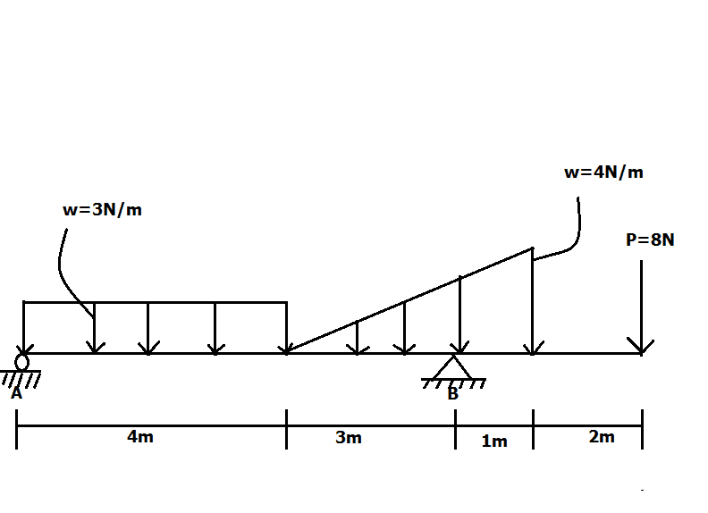

2) Solve for shear and moment at the given distances
a) 5m from ROLLER "A"
b) 9m from ROLLER "A"
SO FAR I GOT THE REACTIONS AT POINT A AND B. 5.525N AND 22.475N RESPECTIVELY
Beam diagram with a pin support at left end A and roller support at B, showing uniform load w=3N/m over 4m, triangular load rising from 0 to w=4N/m over 3m, a point load P=8N at the right end, spans labelled 4m, 3m, 1m and 2m.
Hint on probem A for shear: Write an expression for the shear force starting from point A and moving to the right. You have the reaction at A as 13KN. So at point A the shear force is the upward reaction force, 13N. Beginning at point A you have a varying downward load. It would be the product of the distributed load function and the distance from point A that is of interest. Combine for shear at any point of interest.
The moment is handled in analogous fashion.
