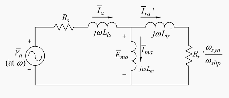

Hi,
I have attached two circuits of an induction motor, one for steady state(1st circuit) and a dynamic model(2nd circuit).
My question is: Why don't we include the induced emf in the steady state circuit? Looking at the dynamic circuit we include it, but not in the steady state circuit. Is the induced emf somehow included in the following term [itex]R_{r}^{'} \cdot \frac{\omega_{syn}}{\omega_{slip}}[/itex] or is this somehow equal to [itex]R_{r} + j \omega_{r} \Psi_{r}^{s}[/itex] in steady state?
Please note that the superscripts [itex]'[/itex] and [itex]^s[/itex] means refereed to stator side.
If any additional information is required please let me know, and I will supply it as soon as possible.

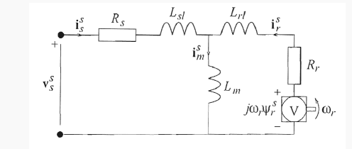

EDIT1:
One more question came to mind, in this term: [itex]j \omega_{r} \Psi_{r}^{s}[/itex] why do we use [itex]\omega_{rotor}[/itex] instead of [itex]\omega_{slip}[/itex]?
Since the induced emf and flux have the following relation [itex]\varepsilon = -\frac{d \lambda}{dt}[/itex] To my understanding I believe we should use the [itex]\omega_{slip}[/itex], because that is the relative motion of the rotor seen from the stator which magnetic flux [itex]\Phi[/itex] is rotating at frequency [itex]\omega_{syn}[/itex].
Steady State Circuit:
Per-phase steady-state equivalent circuit of an induction motor: source Va at frequency omega, series Rs and j omega Lls, shunt magnetising branch j omega Lm with Ema, and rotor branch j omega Llr' in series with Rr'(omega_syn/omega_slip).
Dynamic Circuit:
Dynamic equivalent circuit of an induction motor in the stator reference frame: stator resistor Rs and leakage inductance Lsl in series with rotor leakage Lrl, magnetising inductance Lm shunt branch, rotor resistor Rr, and a voltage source j omega_r psi_r^s with speed arrow omega_r.

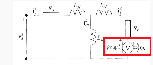

I do not think I understand it fully yet.
Looking at my image below, what does the element inside the red box represent?
My thought is that it represent the the induced emf ([itex]\varepsilon=-\frac{d \lambda}{dt}[/itex]) in the rotor due to relative motion between the rotor squirrel cage and the rotating magnetic field set up by the stator, am I right?
If I am right, then why is the term [itex]j\omega_{r}\Psi_{r}^{s}[/itex] not included in the steady state equivalent circuit of the induction machine?

The dynamic circuit it is not actually a circuit but a symbolic "like" circuit.
The dynamic diagram is referring to space vector [all three phases in matrix form] and connected with Laplace transform [“p” or ” s” noted]. It facilitates to find the Laplace transform for a circuit where instead of derivate it will be p and instead of integral 1/p.
In order to find the actual values you have to integrate the result according to Laplace transform rules.
If you'll write the voltage drops on stator circuit and rotor circuit you’ll get:
Vs s = Rs Is s + p λs s stator circuit
0 = Rr*Ir s + (p - jωo) λr s rotor circuit where:
λs s = Ls Is s + Lm Ir s and λr s = Lm Is s + Lr Ir s
Since Laplace transform is an integral you have to consider the limits and the lower limit is rotor velocity [wo=wr].So jωo λr s= jωrΨs
