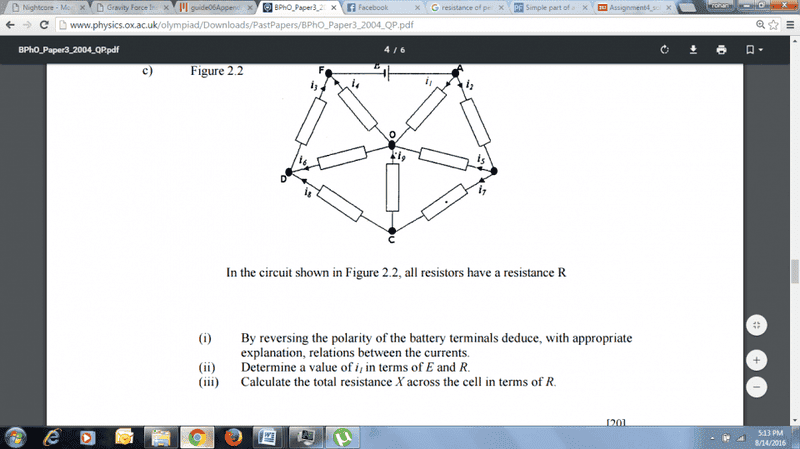

Here: http://imgur.com/a/5rRgu
2. Homework Equations
V=IR
Basically from reversing the polarity of the cell and looking at a mirror image of the circuit i got the following relationships. First I(9)=0 then I(1)=-I(4) I(5)=-I(6) I(7)=-I(8). I believe i can also get these from a symmetry argument. From there I went ahead and wrote down equations for the currents at points A,B,C and O. I inserted the current through the cell to be I(10) and after a few equations i got I(10)=0 and so the equivalent resistance to be infinite ?? I made a mistake somewhere. Is it just a mistake during my calculations or is my approach wrong? I believe the error might be I(9)=0 but I'm not sure

Use a symmetry argument to determine the potential differences between O and F, and O and A.
If I(9) is zero, what can you do with the resistor OC? (what's the potential drop across it?)

So basicaly i can simplify the circuit by removing OC completely from the diagram.
Now i just have a square of resistors. From the symmetry the pd across OF and OA should be equal and so that should be E/2
Since the current through FD and AB should have the same magnitude their pd should be the same. Considering DO and OB these two should also have the same pd. and so the pd across DB is zero. So i can now remove the segment DB ( from my square). From this the circuit is simplified to 2 identical systems of resistors in series where each 'system' is R and 2R in parrallel. So the total resistance is 4R/3. Is that correct ? ( this is preparation for a contest and the answers are not available online )
Also what was wrong with my approach before using currents?

Careful. While the magnitudes of potentials OD and OB may be the same, they will have different signs. Remember, the cell has a polarity and the symmetric currents have opposite directions.
Hard to say since you gave no details of your equations or your manipulations of them.

Consider instead replacing the resistor OC with a wire (short circuit). Since no current flows through it you have the choice of removing it entirely or replacing it with a short. Choosing the short circuit option gives you some parallel and series resistor reductions to exploit.

Okay so i have no idea if this is correct or not but it should be.
First We have I(1)=I(4), I(6)=I(5), I(7)=I(8) and I(9)=0 ( all of these by looking at the symmetry of the circuit )
If we can assume V(A)=E and V(F)=0.
Since I(1)=I(4), the pd across FO and OA is the same.
V(O)-0=V(A)-V(O)
V(O)=E/2
So I(1)= E/2R
Since I(9)=0 V(C)=V(O)=E/2 this implies that the pd across BC= pd across BO
So I(5)=I(2)/2
Applying kirchhoffs rule ( forgot which one xD) in loop AOB :
I(2)R+I(5)R-I(1)R=0 and solving for I(2)
We get I(2)=2I(1)/3=E/3R.
Now the current through the Cell is I(10)
at A we get :
I(10)=I(2)+I(1)=E/3R + E/2R=5E/6R
If the resistance of the circuit id R(eff), we get E=I(10)*R(eff) solving for R(eff) we get R(eff)=6R/5

That looks perfectly good.
