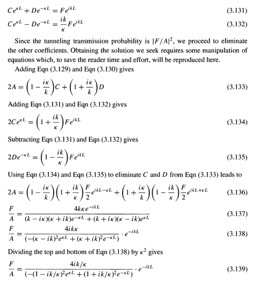

Hi,
http://books.google.at/books?id=40rRzNbuhpAC&pg=PA146
Can anybody explain me why in the third bracket in 3.139 is suddenly a minus instead of a plus? In 3.136 it is a Plus! And it is pure substitution as far as I understand...
And I checked everything before a few times: It should be correct!
And the next crazy stuff: From where does suddenly the "i" in the numerator (3.140) appear?
Thank you :-)
divB
Hi divB!
You're absolutely right. There is a plus sign in the 3rd bracket and some confusion with factors of i in (3.140).
I found a later version of his book, where the errors are corrected. I attached a bmp of the relevant page.
Enjoy the book!
Best regards Martin
GREAT! Thank you very much!
I can't believe it! It took me at least 5 hours ;-)
Thank you!
