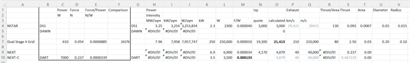

Hi, yes I concur after adjusting the formula in my spreadsheet for p = E/c.

System input power - 0.6 – 7.4 kW
Thrust - 25-235 mN
Isp - 4220 s max, 4190 s was mentioned in the webpage article, which is a 1.34 improvement over NSTAR (used on DS1 and DAWN) ~3100 s (90 mN thrust). NEXT-C thrust is about 2.6 times that of NSTAR.
https://en.wikipedia.org/wiki/NASA_Solar_Technology_Application_Readiness#ApplicationsDART apparently experienced problems with the NEXT-C propulsion.
https://en.wikipedia.org/wiki/Double_Asteroid_Redirection_Test#Ion_thruster
Early tests of the ion thruster revealed a reset mode that induced higher current (100 A) in the spacecraft structure than expected (25 A). It was decided not to use the ion thruster further as the mission could be accomplished without it, using conventional thrusters fueled by the 110 pounds of hydrazine onboard.
NSTAR performance: "The 30-cm ion thruster operates over a 0.5 kW to 2.3 kW input power range providing thrust from 19 mN to 92 mN. The specific impulse ranges from 1900 s at 0.5 kW to 3100 s at 2.3 kW." Ref: https://en.wikipedia.org/wiki/NASA_Solar_Technology_Application_Readiness#Performance
NEXT-C performance: "NEXT can consume 6.9 kW power to produce 237 mN thrust, with a specific impulse of 4,170 seconds", or can be throttled down to 0.5 kW power, when it has a specific impulse of 1320 seconds. Ref: https://en.wikipedia.org/wiki/NEXT_(ion_thruster)#Performance
https://ntrs.nasa.gov/citations/20110000521
Some values of performance characteristics seem to vary among different sources.
NEXT-C gave greater thrust and Isp by using greater power levels. One has to consider available kW, and the voltage and current. It would be useful to dig deeper into the NSTAR and NEXT designs.
6.9 kW (NEXT)/2.3 kW (NSTAR) ~ 3, which gave an improvement of thrust 237 mN (NEXT)/90 mN (NSTAR) ~ 2.6, with an Isp improvement of 1.34.
The missions of DS1, DAWN and DART were different, so in addition to differences in power supply, it is difficult to compare the relative performance of the thruster involved.
Still, there are a long way from kN thrust levels, or multi-MW power supplies.
