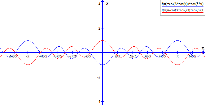

Let's take a look at the graphs. Here is the graph for the real part for ##z=3## and ##m=3##:
As you see, the graphs won't be equal, but the integrals will be. I hope this reassures you that your result is correct.

Why do you think the integrals are not equal? Doesn't my graph show you that they were equal (for a special case, ok)?
