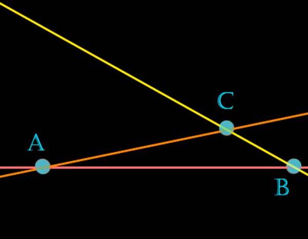

1) Can two events which are simultaneous in one frame of reference (FOR) be simultaneous in another - that is - THE SAME TWO EVENTS, or is the simultaneity limited to only ONE FOR.
2) Can one always find an FOR in which any two event pairs are simultaneous?
3) It would seem that an event A can be simultaneous with an event B in one FOR and also be simultaneous with event C in a second FOR. This does not mean that B and C are simultaneous but it should be possible to find an FOR in which they are. Again, this would NOT mean that [tex]\exists[/tex] an FOR in which A, B and C are simultaneous mutually, or does it?
1) If you take a look at a Minowski diagram, you will notice that the slope of the simultaneity line is linearly proportional to the velocity. Therefore, the answer is no.
2) No. Mark the two events in a spacetime diagram and draw a straight line from one to the other. If the slope of this line is greater than or equal to c, there is no intertial frame in which they are simultaneous.
I *think* the answer to (a) is yes. Imagine a frame F traveling in the x direction compared with frame G, and think about events that lie on the y-axis - that is, events that lie on a line at right angles to the direction of motion. I think both frames will agree on the times of such events, and two events simultaneous in G will be simultaneous in F.

Ah 3 - I'm even less sure of my answer here - but
I think if A and B are spacelike related and A and C are space-like related, then B and C are space-like related. If there's a frame where A and B are simultaneous, then they're space-like related; ditto for A and C. So B and C are space-like related, so there's a frame where they're simultaneous.
But this certainly doesn't mean you can find a frame where all events are simultaneous.
But I would wait until a professional confirms or disproves what I say here!
No. Your premises are that A and B are spacelike separated, and A and C are spacelike separated. It is easy to come up with an A, B, and C such that B and C are timelike separated. This means there's no FOR in which they're simultaneous.
For example, consider one FOR with (x, t) coordinates (assume c = 1)
A = (0.0, 0.0)
B = (1.0, 0.0)
C = (1.0, 0.1)
A is clearly simultaneous with B. A is also spacelike separated from C, so it is simultaneous with it in another FOR. But B and C are clearly timelike separated. They are not simultaneous in any FOR.
Another way of stating this is that it's possible for a massive object to go from B to C without reaching the speed of light. This means that B precedes C causally, and this must be true in every FOR, thus they are simultaneous in none.
I disagree with the bit I've emboldened. It might be possible to find such an FOR, but it won't necessarily be possible. Whether such an FOR exists will depend on the absolute position of C relative to B in spacetime. Among the infinitely many events that A is simultaneous with in the second FOR, there will always be some at causal separations from B (timelike and lightlike), and there are no FORs in which such events are simultaneous with B.
(I assume, in 3, you're saying "this does not meant that B and C are simultaneous" in the FOR where A and C are simultaneous (which is true: B and C are not necessarily simultaneous unless they're identical)).
Maybe someone more knowledgeable than me can answer the questions for general coordinates in flat spacetime and for curved spacetime.

where:
[tex]t'_A=\gamma(v)(t_A-\frac{vx_A}{c^2})[/tex]
If you want for B and C to be simultaneous, this simply means [tex]t_A=t'_A[/tex]
i.e.
[tex]t_A=\gamma(v)(t_A-\frac{vx_A}{c^2})[/tex]
The above is a simple equation in v with the solution:
[tex]v=\frac{2x_At_A}{t_A^2+(x_A/c)^2}<c[/tex]
So, you can always find a frame F' that satisfies your condition 3. It is interesting to note that the speed v between F and F' depends only on the spacetime coordinates of A.
I'm pretty sure this isn't right. For example, it's possible that [itex]A = (0, 0)[/itex], and then [itex]v = 0/0[/itex], undefined.
The velocity of the frame in which [itex]B[/itex] and [itex]C[/itex] are simultaneous is, I believe,
[itex]v = c^2 \frac{t_C - t_B}{x_C - x_B}[/itex].
Of course, if [itex]v \ge c[/itex], then the frame is not physically realistic.
No, you don't:[tex]t_A=\gamma(v)(t_A-\frac{vx_A}{c^2})[/tex]
For [tex]t_A=x_A=0[/tex] the above reduces to 0=0, satisfied for any v.
Welll, I showed my derivation, let's see yours and we'll figure out which one is wrong.
hmph.
My guess is djy is using the idea that an object's worldline is orthogonal to that object's simultaneity line to find the pertinent velocity. But Starthaus' method seemed plausible too - the only part of Starthaus' derivation I couldn't follow was the final line. Starthaus, care to give us a hint how you got your expression for v from your expression from tA?
yossell said:
hmph.
Sure, solve for v:[tex]t_A=\gamma(v)(t_A-\frac{vx_A}{c^2})[/tex]
BTW, if you take [tex]t_A=x_A=0[/tex] as djy wants to, you get 0=0, satified for any v.
starthaus said:
Sure, solve for v:
lol - well of course, but I couldn't as I was getting fourth powers of v - but I see now I had gamma all wrong, and it all works out as you said. So now both of you have convinced me and I've got to think again...
