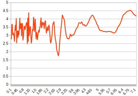

When I did this experiment I found the elementary charge "by eye", but I was curious about a more mathematical approach.
Quick and dirty:
* Pick a number for the smallest mass unit
* Uniformly randomly multiply this by 1 to 10, then vary it by up to 5% with a uniform distribution. Add a uniform noise of -0.3 to 0.3 of that smallest unit. Repeat this 40 times.
* For each given mass unit hypothesis, find the relative difference between closest multiple and simulated measurement, square it. Sum over all 40 values. Smaller means a better fit.
This isn't given higher weight to smaller values, or actually calculating the likelihood - these things would improve the quality.
Here is the resulting graph. Guess which value I chose for the smallest unit.
2.7246, right in that prominent deep dip
boy, that's pretty noisy data. Not much difference between right and almost right. I'd be interested in how it looks if you just looked at the 20 smallest values. Maybe even 10.

Well, quick and dirty.
But it's quite robust, the strongest negative peak is always there. Keep in mind that this is not a log likelihood function - this is something hacked together in a spreadsheet, so the y-axis is arbitrary.
There's more information here. Your dip is at y=.7. Since you have 40 points, that means the average difference between the points in the dip and the nearest integer is 0.2. The other candidate peaks are at 2.5, which means their average is 0.25, which is the average distance to the nearest integer for a uniformly distributed random number.
The range -0.3 to 0.3 has a standard deviation of 0.6/sqrt(12) = 0.17. That's pretty close to 0.2, which suggests that the whole measurement is driven by a small number of well-measured points.
That's fore sure. It's speculation that these well measured points are also the points with a small number of electrons, but I bet it is right.
