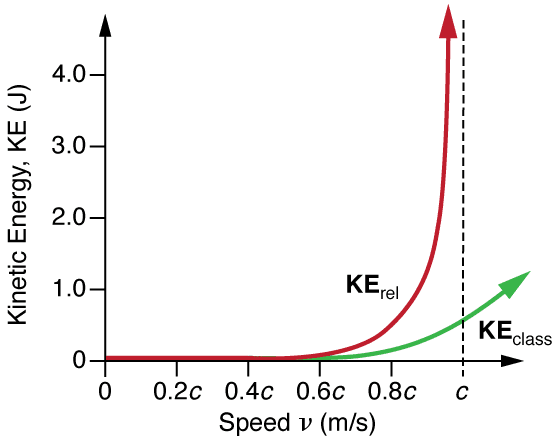

jeremyfiennes said:
What is the best recent experimental evidence for effective mass increase (momentum/velocity) with speed, with experimental details? Searching the web all I find is either very old ones (early 1900s).
That's because researchers stopped referring to it as an increase in mass many decades ago. In more recent decades introductory college-level textbooks have followed suit.
What's actually happening is, due to the geometry of spacetime, the amount of energy it takes to speed up a particle increases beyond all bounds (approaches infinity, as they say) as the particle's speed approaches ##c##. This is a fact of life, proven every day at places all over the world.
Here's a graph of the data you asked for, taken from
https://courses.lumenlearning.com/physics/chapter/28-6-relativistic-energy/
