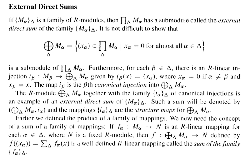

The definition of External Direct Sum is as follows:
I have had difficulty in formulating a rigorous and convincing proof of the statement in Problem 1(b) ... can someone please
(1) critique my attempt at a proof (see below)
(2) provide an alternate rigorous and convincing proofMy attempt at a proof is as follows:
