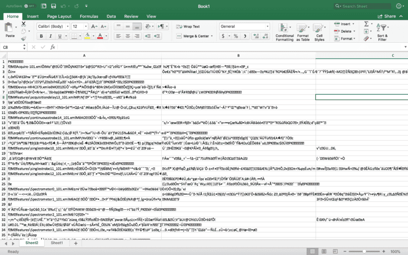

Good morning,
I used the Laser beam with HR4000 spectrometer with Ocean View software when saving the files it is saved by (.ocv) format. when trying to extract information to excel I get some unreadable data like (bkg thin sheet gel.png) attached. I used the same instrument and software with the yellow light but used solution of the mix not gelatine sheets, and i was able to convert it using excel but with the laser and gelatine sheet this is what I got I could not convert it.
This is the link i used to convert the data
Please help.
Thanks
  • Screenshot of a Microsoft Excel spreadsheet titled Book1 filled with garbled, unreadable characters across columns A and B, showing a binary-like file dump rather than numeric spectral data.
Just a guess, but .ocv sounds like "Ocean View," so it might be a proprietary file format from the company. To import into Excel, it has to be ASCII data, like the .csv (Comma Separated Values) mentioned in the link.

You have to make sure that you are choosing the right file type when exporting from the spectroscopy software.

In the spectroscopy software I only have one option of(.ocv) format nothing else.
If it worked for one it should work for the other - it's the same software, right? OceanView? On page 44 of the manual it has a picture of the dialog box, with "ascii" selected...
The PK at the beginning strongly suggests it is a compressed file. Have you tried opening it with a compression software?
