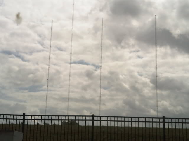

Here is a picture of all of them together.
I realize that this was a stupid thing to do. I am glad that I didn't get electrocuted, but now I'm just concerned about radiation.
I'm not sure but it's possible that this is AM radio beam antenna. And it could have been transmitting. It's hard to see if there is a feed to one of them. Is there anything that looks like http://en.wikipedia.org/wiki/File:Base_feed.spliced.jpg" ?
Again, you were lucky. As to any radiation damage you may of suffered, I have no idea.

Yes, there was a large box right by the tower. I'm pretty sure it is an AM tower because I managed to find some info on the licensee and it said those towers are an AM array.
There was no hum from the box, and everything around it look old. There was no heat or anything from the tower all the way up. And I directly touched the tower while I was still standing on the ground, no shock.
Hopefully if it was going to do some damage, I would have at least felt some heat or have been burned. I feel perfectly fine, I just have scars from the barbed wire fence.
Again, very stupid idea. Thanks for the info about the forum rules, I accidentally disregarded that in my frantic state. And thanks for the help so far!

Here is a link to the license which has been canceled.
http://wireless2.fcc.gov/UlsApp/UlsSearch/license.jsp?licKey=1021948
This is the only license I can find for this location so it looks like the tower is no longer being used.
It was not an AM station but operating on 957.95 MHz at 3800 watts. Had you gotten in front of that antenna when it was operating, it could have been a lot worse than had it been an AM station.
You would not have survived close proximity to a 50,000 watt am or fm transmitting antenna. It's not ionizing radiation so you won't die days later like with a nuclear reactor. It's a high electric field which would have disoriented you and you would have fallen to your death.

Antennas for most frequencies are relatively small and are supported by the tower or mast.
In this case, the antenna has been removed and the first photo is of the mounting bracket for the antenna.
If there had been an operating dish there, it is hard to have much sympathy for someone who climbed 143 meters to put his head in front of it. The effect would be pretty much like getting inside a microwave oven.
For the AM broadcast band (1 MHz +/- 0.5 MHz) the tower is the antenna. It is usually fed at the bottom and insulated from ground. A buried network of metallic conductors is an important part of the antenna. Some of the supporting wires may also form part of the antenna where they are connected at the top of the vertical structure.
The feedpoint at the bottom is at low impedance, but the high power involved means this can still be fed at a high voltage.
A 10 KW transmitter feeding an antenna at 50 ohms would be producing 707 volts rms.
A much greater danger in this case was that this site has been abandoned for 12 years, so there could be missing or rusted bolts or guy wires which would weaken the mast and possibly allow it to fall over taking the (presumably) intoxicated climber with it.
