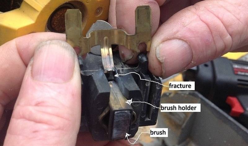

I recently fixed an expensive electric saw by simply cleaning grime out of the brush holders - it had jammed the brushes in place and they lost contact with the armature.

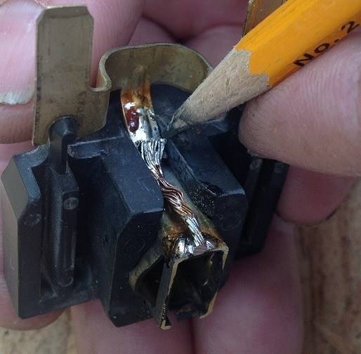

Fixed another one that had a fractured brush holder, likely from thermal cycling because it had got covered up with sawdust.
Just soldered a piece of flexible wire across the fracture . Now the rigid brass part is free to shrink & swell a little bit with temperature..
Keep it "Taut Clean and Cool" is one of the fundamentals of electrical maintenance.
Designers allow for thermal expansion that occurs with changing load. Probably this particular holder fell victim to tolerance stackup.
