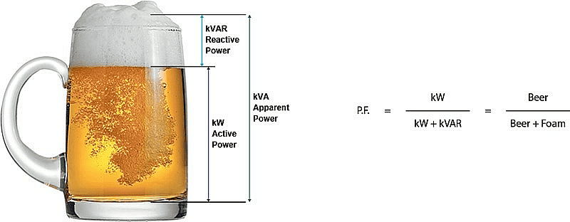

Factor (P.F.) is the ratio of Working Power to Apparent Power.
KVAR is reactive power. The power of your transformer uses to produce magnetizing flux.
KVA is apparent power and that is Vectorial Summation of KVAR and KW.
KW is working power. The power that performs useful work.
I like the beer and analogy.
  • PowerFactorBasics.pdf
Thanks for the reply and the thirsty analogy! My question is; how do I summate the two kVA readings to provide a composite total kVA for the facility in question?
