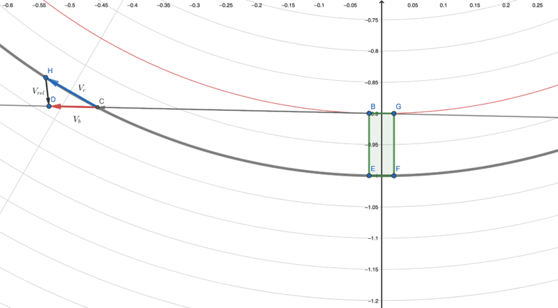

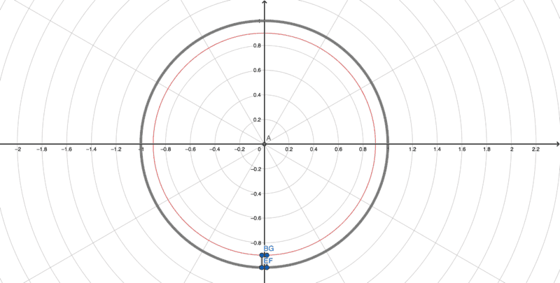

Here is a scenario where you step off a building in an O'Neill colony assuming at first the building does not interfere with your path (you step to the side a bit). The cylinder is spinning clockwise and ##V_b## is the tangential velocity at the height of the building while ##V_c## is at the ground level and ##V_{rel}## is the relative velocity wrt to the ground. This assumes you just step off the building with no other velocity. I have not shown where the building is when you reach the ground.
The larger perspective;
Not the same as gravity. If you don't like equations, I thought this video was amusing.
In my scenario above stepping off a 100m building in an O'Neill cylinder of radius 1km would result in hitting the surface at over 150km/hr which is just a little less than falling from the same height on earth. For small heights it would feel similar to being on earth.
