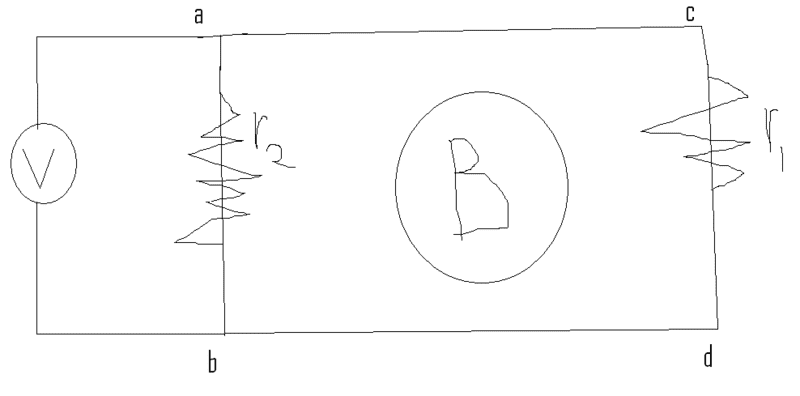

ok sir if i have this following circuit the
Hand-drawn circuit diagram: a large rectangular loop containing a circle with a handwritten B, with a zigzag resistor on its left and right sides and a voltmeter-style circle symbol with a V at each outer end.
say the magnetic field is increasing into the page and the right resistor in r1 and left resistor is r2 there will be current in the clockwise direction induced after that how to solve the problem
I am 22 and I just graduated. No need to address me as 'sir'. :wink:
The current will be anticlockwise.
Let's take only one voltmeter and connect it first on the left and then on the right.
(Two voltmeters at the same time might make the problem complicated. I'll have to think about it.)
You can write KVL equation for the rectangular loop as follows: I(r1+r2)=AdB/dt.
This will give you the current I.
About the voltmeter reading:
If the voltmeter is placed on the left,
IR1+Vleft=AdB/dt
So,
Vleft=AdB/dt-IR1
Similarly, if the voltmeter is placed on the right,
IR2+Vright=AdB/dt
Vright=AdB/dt-IR2.
Note that the polarities of the two voltmeter readings will be opposite. Can you say why?

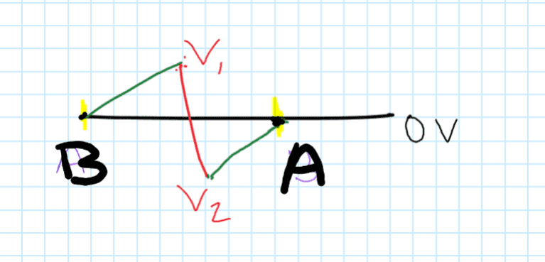

rude man said:
If the voltmeter loop is to the left of the circle such that there is no B field anywhere inside the loop then the reading will be VB - VA = 1A x 1Ω = +1V, clockwise current assumed.
If the voltmeter loop is to the right of the circle such that there is no B field anywhere inside the loop then the reading will be VA - VB = 1A x 2Ω = +2V, clockwise current assumed.
Note the difference in polarity of the two voltages. B-A in one, A-B in the other.
@cnh1995 did I get that right?
Yes.:smile:

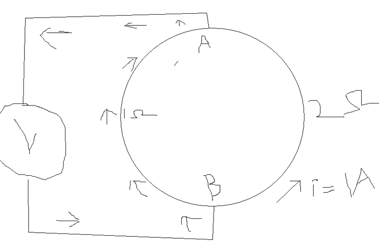

wait so the potential between a and b is 0.5 v
@rude man
i thought we were using a anti clockwise current
so
Hand-drawn circuit diagram: a circular loop with points labelled A, B and S on it, a voltmeter V on the left connected by wires to the loop, and an arrow labelled i = 1A showing current direction.
how can i write the kvl for this voltmeter loop
  • Hand-drawn circuit diagram: a rectangular loop with a voltmeter labelled V on the left, a large circle on the right with points A, B, and S marked, arrows showing current direction around the loop.
  • Hand-drawn circuit diagram: a circular loop with points labelled A, B and S on it, a voltmeter V on the left connected by wires to the loop, and an arrow labelled i = 1A showing current direction.

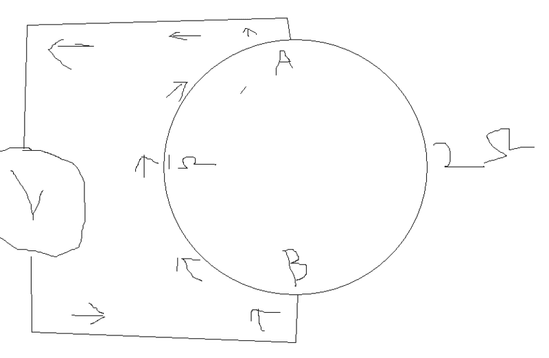

rude man said:
If you hook up the voltmeter so that the leads and meter form a loop which does not encircle any B field, then the voltmeter reading would be iR where i = πa⋅dB/dt and R the resistance between the two points. Remember: the loop cannot encircle any B field. If the loop did include any B field you should expect the readings to be different and not just iR.
cnh1995 said:
Assuming the voltmeter loop doesn't enclose any flux..
This would be true only if the circle does NOT have a uniform resistance, which is not the case with OP's circuit. The resistance of the circle in OP's diagram is uniform (3r1) and hence, the voltmeter will read zero between any two points (without the triangle inscribed in the circle).
Is there a disagreement here? Let's make sure we are considering the same setup. We have a circular ring with B field confined to the interior of the ring.
Circuit diagram of a circular loop with B into page and decreasing inside it, a current arrow i running around the top, a green section labeled R on the lower right, and a voltmeter labeled V connected across that section.
I think the voltmeter would read iR as rude man says, where R is the resistance of the green section. This would be true whether or not the ring has a uniform resistance per unit length.
  • Circuit diagram of a circular loop with B into page and decreasing inside it, a current arrow i running around the top, a green section labeled R on the lower right, and a voltmeter labeled V connected across that section.
