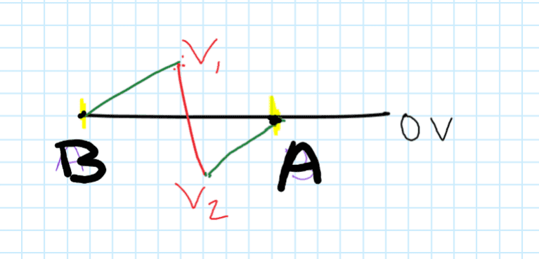

@TSny, suppose the resistance of this ring is uniform and the total emf induced in the ring is 10V, anticlockwise. Let's call the top and bottom terminals of the voltmeter V2 and V1 respectively.
Diagram of a circular loop with points A at the top and B at the bottom, with a shaded region outside the circle bounded by a rectangle on the right containing a voltmeter labelled V.
So the voltmeter should read 5V, with V2 -ve (top) and V1 +ve (bottom).
Now, the "electrostatic voltage" between A and V2 should not be zero even though the resistance of the wire connecting them is zero. Ditto for B and V1.
Assuming the voltmeter doesn't draw any current, the "electrostatic potential" along the wire from B to A through the meter should look something like this.
Hand-drawn diagram: a horizontal black line with points B on the left and A on the right, labelled OV at its right end. Green wires run from B up to a point V1 and from A down to a point V2, with a red line joining V1 and V2, forming a triangle-like loop.
It won't be all straight lines as the induced emf varies along the length of the wire, but this gives an idea about the electrostatic voltage gradient along the voltmeter probes.
Do you agree with this?

rude man said:
I see no other way to reconcile cnh's post 72 with what we (I hope) believe would be emf/2 with fig. 1 assuming a and b are 180 deg. apart.
They are 90 degrees apart as TSny has mentioned in #74.
Assuming the voltmeter doesn't draw any current, the "electrostatic potential" along the wire from B to A through the meter should look something like this.View attachment 213405
Yes, I agree with all of this.

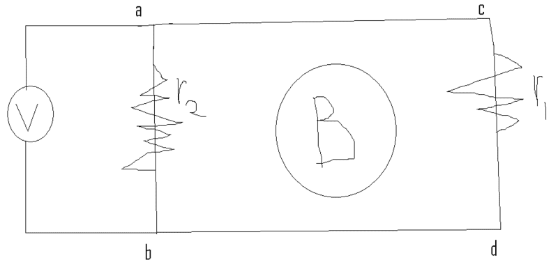

@chn1995 thanks now returning to walter lewin problem
Circuit diagram: a voltmeter V on the left connects across corners a and b; resistor r2 sits on the left branch, a large circle with a B symbol in the centre is the field region, and resistor r1 is on the right branch between c and d.
say the magnetic field is causing emf e in the clockwise direction
by symetry the induced emf along ab and cd will be the same
but to make the current same in the circuit electrostatic voltage will develop across a and b and c and d to even out the current
current induced in entire circuit is ##\frac{e}{r_1 + r_2}##
assuming ##r_2 > r_1## then ##v_B > v_A## then the equation is
\frac{v_B - v_A}{r_2} + \frac{e}{2 r_2} = \frac{e}{r_1 + r_2}
where the voltmeter measures ##v_B - v_A##
is this correct?
is thius correct?
The voltmeter reads either ir1 or ir2 depending on where it is placed. It is not necessarily VA-VB.
oh wait sorry i got mixed with voltmeter readings and electrostatic voltage
the first term is electrostatic voltage
the second term is em induced emf
the right hand side is net emf
is that correct

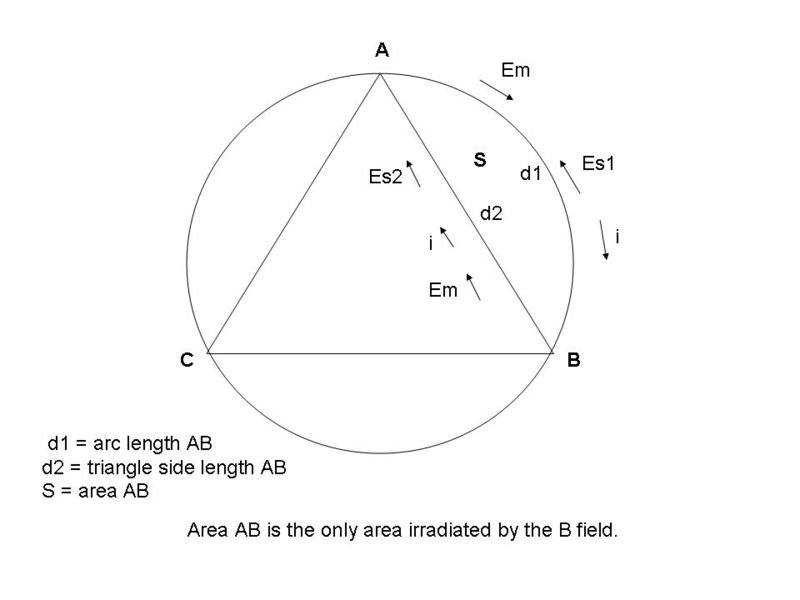

Just to wrap up the OP’S original post::
Diagram of a circle with an inscribed equilateral triangle ABC; side AB is labelled with fields Em, Es1, Es2, current i, arc d1, chord d2 and area S, with the note that area AB alone is irradiated by the B field.
Let
d1 = length of one arc (=2πa/3),
d2 = length of one side of the triangle,
S = area A-B,
The strategy is to irradiate (apply the B field to) the triangle area A-B-C and area A-B separately, then vectorially add the various Es and Em (static and emf) fields by superposition. The other segments, not abutting the A-B loop, can be ignored altogether; whether or not they are irradiated does not affect the E fields in the two A-B segments.
We first note that when just the triangle area is irradiated. there is no Es field. This means that the triangle area can also be ignored since potential differences are line-integrated Es fields only.
So we irradiate S only:
If Em = emf field around the A-B loop and i the corresponding current,
emf = Em(d1 + d2) = -S dB/dt = i(r1 + r2) so we know Em and i;
and if
Es1 = static field along arc AB,
Es2 = static field along the triangle side AB,
from the basic relation j = σE, j = current density, E = Em + Es, we get
Let
S = area A-B,
and if
i = (Em - Es1)d1/r1 or
Es1 = (1/d1)(Em d1 - i r1) = Em - i r1/d1
and similarly
Es2 = r2 i/d2 - Em.
Then ΔV = Es1 d1 = Es2 d2.
The rest is geometry and substitution.
Note that this computation is not that of a voltmeter (by all we have discussed so far) measuring voltage between A and B. The voltmeter reading is in fact VB - VA = -r1 i.
