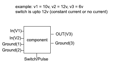

Hi
Anyone knows of an electric component that can switch between two input powers.
I have two DC input power,s one is 10V/2A and the second is 12V/2A . I want to be able to switch between the two without interrupting the function of my circuit . meaning without my circuit going off in between the switch.
output can be 6V/2A (I am Flex)
Just wanted to know what is the name of this electric component that can witch between the two without dropping power . I guess it is a fast switch with some kind of a capacitor . if you have a link to the actual component that would be very helpful .
Thank You

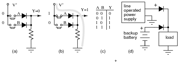

Have you found "Diode OR" in your Google searches for circuits?

okay i made a little diagram . maybe this will clear things out ... ?
is there such a component?

When you diode OR, it is usually one diode per supplying rail, hence two diodes in your case.

Like that ?
and then i need to place a switch between the diodes and the load ?
the question which ground should i use , i know its intuitive to say any of them but i know there is some difference . ?
No, there is only one diode, the other is replaced with a switch.
Use circuit d.
There is only one Earth and it is common to all. Join all the Earth points together.
Keep the power diode on the 10V/2A supply. That is the lower voltage supply.
Replace the diode on the higher voltage 12V2A supply with a simple switch.

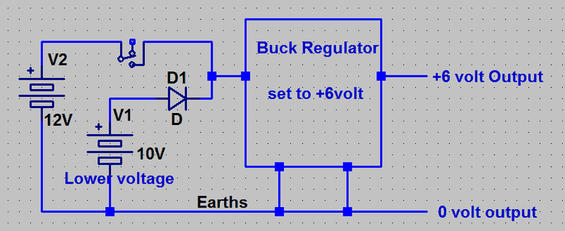

then i will have another issue. because the output won't be a constant v. i want it to be 6v
its two different inputs and one regulated output. granted i know i have to keep the inputs above a certain threshold depending on the component .
Then you need a voltage regulator to take the combined power.
Such as a; “DC 3~40V to DC 1.5~35V Voltage Step Down Transformer Module”. Set it to give 6V.
I have been using these converters from http://www.dx.com/
SKU 154907 cost is about US$3.00
They are DC switching converters which are more efficient than linear regulators so will give longer battery life.

how do i connect all of them . two batteries , regulator , diodes ..?
do i connect before the buck or after the buck ?
See attached diagram.
