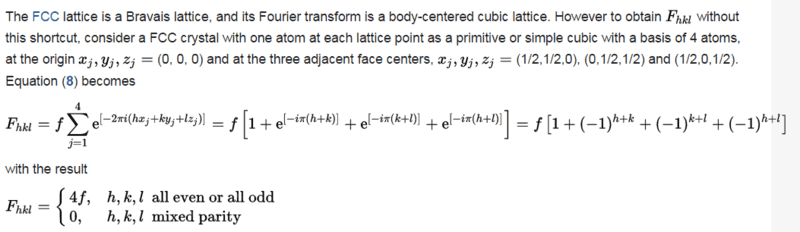

I tried to treat FCC lattice with a lattice constant a, as a monoatomic lattice.
The reciprocal lattice is a BCC with a lattice constant 2pi/a.
And the structure factor is 1.
But I can treat FCC lattice with a lattice constant a, as a simple cubic lattice,
with 4 atoms in each unit cell. As one can see in Wikipedia:
Now the distance between adjacent planes in the reciprocal lattice is
as in a simple cubic: a/sqrt(h^2+k^2+l^2),and I cannot see
how I can get the same wavelengths,according to Bragg's diffraction.
