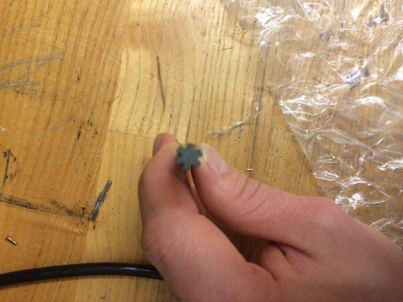

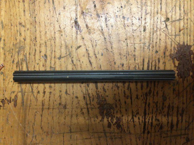

Hello!
We are working with some ferrite rods to build solenoid magnetorquers for a cubesat design. The geometry on these rods is unique. Are there benefits to this type of a geometry?
They are 19.6 cm length x .67cm diameter.
Can you give us a part number or a link to the manufacturer of the 6 fluted rods? What are they designed to do?
Since your coil does not contain ferrite where the flutes are, you will need a longer wire to surround the same section of ferrite. That will weigh more than when wound on a simple cylindrical rod.
I see! Good to know, so you would even recommend to just use a simple cylinder? We are trying to maximize magnetic dipole moment for torque against the magnetic field of the Earth.
As to part numbers etc, I wish. I have no part information. I am working on our team leads to get some more data on them. In the meantime, I thought I would ask on here from a physics standpoint how the flutes will affect things.
