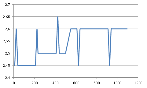

Whats the way to go to apply filter to a pulse signal?
I have a signal with some weak triangle pulses, positive or negative, mixed with some very slow sine wave. I've tried to illustrate this in the attachment. The sine is actually slower than it looks in the chart I don't really know how low frequency it has, but I know it's less than 1Hz. The pulses has a length of 30-50us and they come about every 200-220us.
My goal is to feed this signal into a microcontroller. The controller needs to count pulses and know if they are negative or positive. My challenge is that the pulses are so weak that they have to be amplified, without amplifying everything else. In other words, a highpass filter. The thing with any kind of filter is that signals are weakened - in particular pulses. And that's really the issue I run into in my attempts with this.
So my idea to work around this is to send the signal through two parallel circuits with an opamp in each - one that do lowpass, and one that do nothing except for make the same delay as the lowpass. Then feed the output from those two circuits into a the next stage that subtracts the lowpass filtered signal from the original. The result should then contain pulses only - I thought.
It turns out that even with second order lowpass the output of the filter is affected by the pulses, and the signal that is supposed to pass untouched is also affected by the filter in the parallel circuit. And the subtraction method requires gain from the two parallel circuits to be equal - that wasn't so easy to get properly either.
So, what's the way to apply filter to pulse signals?

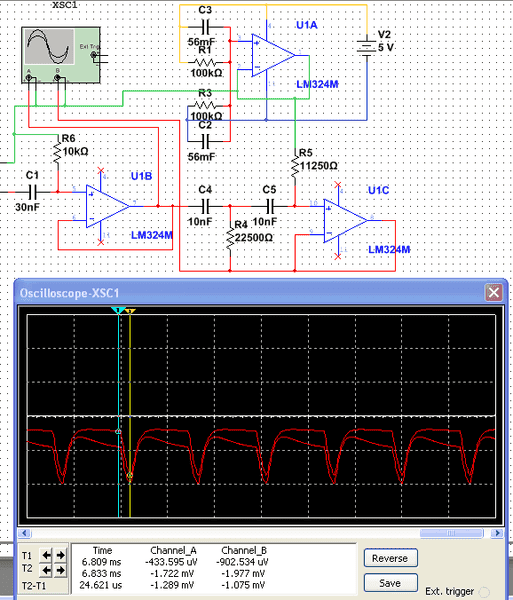

Attached is my highpass approach.
Input is wires coming in from the left.
U1A is virtual ground generator.
U1B is an impedance buffer, having a DC block before it.
U1C and the RC's in front of it is the highpass filter.
Ch.A on the scoop is output from U1B. It's almost flat between the pulses. Voltage in the pulse max is about 4 times the level of voltage between the pulses.
Ch.B is output from U1C. It's starting to look more like sawtooth. Voltage in the pulse max is only about double the level of voltage between the pulses. And the voltage between the pulses are stronger than before the filter. So I've managed to get only the negative effects of the filter, none of the positive ones.
That's why I don't think highpass is the way to go.

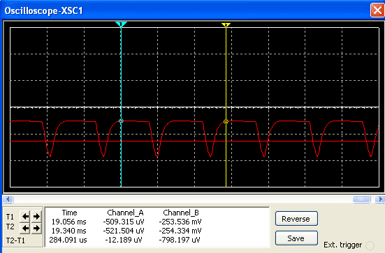

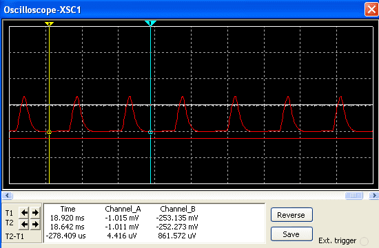

Here comes lowpass scoopshots. I suspect the simulation is wrong, cause what I did between those two shots was to swap the input wires. I my head this should make signal mirror around 0V, which it doesn't.
If the simulation is correct, I don't see how I can use the lowpassed signal any further, as I seems to be independent of voltage level between the pulses.
RC-net for lowpass is set for 18Hz, 2nd order.

That's a weird circuit. Did you make it up? Where does the AC input connect to? Oh, it's a way to halve your supply voltage. Why aren't you using a double power supply?

not sure I understand the red part.
Observe C1R6 form a differentiator
and it looks to me like ChA is about what you wanted to accomplish.
What does it look like if you skip U1B and feed input straight into C4?
EDIT: PS I would connect my scope common to negative side of 5volt supply.
Why ?
Virtual ground is only as stout as the op-amp that's creating it.
Power supply rails are quite rigid in comparison, that's why they are called 'rails'.
Then your 'scope trace will center around mid power supply and it'll be clear when you hit a 0 or 4 volt limit.
And you could monitor virtual ground, too.
late addition: You're aware that C3-C2 form a capacitive voltage divider for power supply noise... your virtual ground will be better behaved without C3. And C2 can be large.

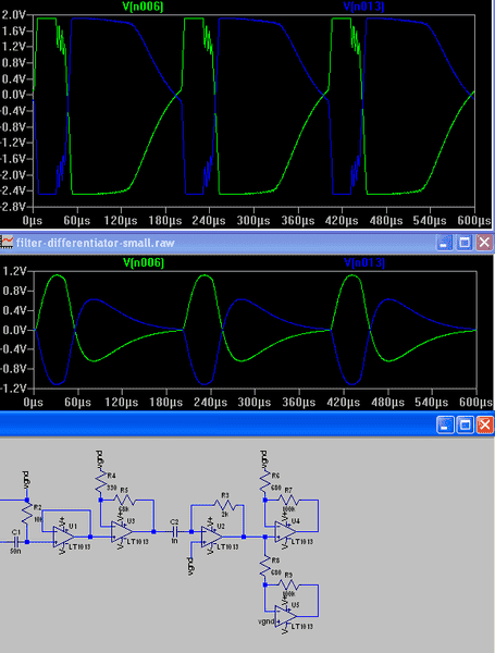

Attached is an attempt using 4th order, bessel highpass tuned for 300Hz. Green is the output of U1, blue is the output of U2 and red is output from U3. It seems to just add DC.
Same circuit tuned for 3kHz makes sawtooth output. As the other high pass attempts, I don't see how they can be useful for pulse signals.

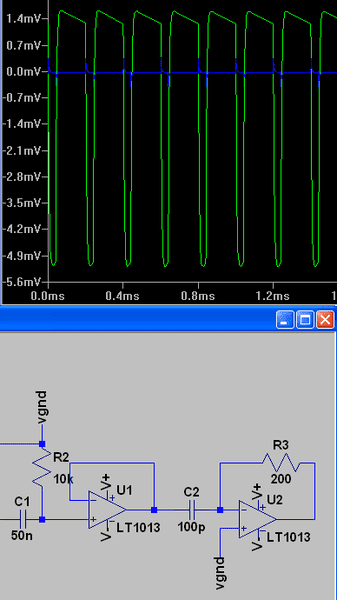

Attached is also an test with a differentiator. With C2=[100p;500p] it responds quite well to the pulse edges. It's well balanced around 0. For some reason it's amplitude is different when the connectors is swapped.
This could clearly be used to trigger a monostable... but how should the direction of the pulse be identified?
