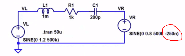

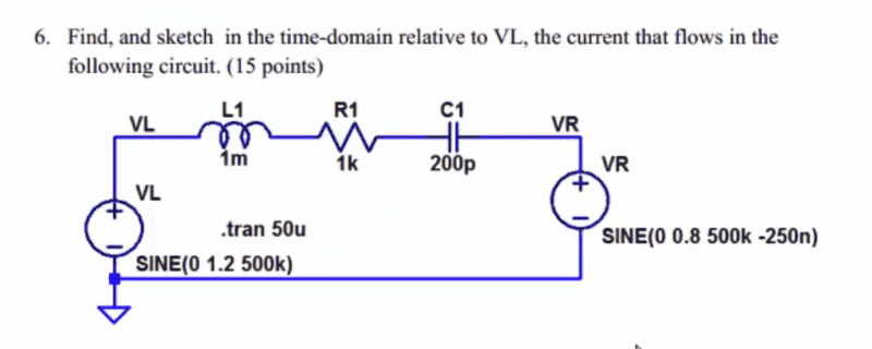

Circuit schematic with a sinusoidal source labelled VL in series with inductor L1 (1m), resistor R1 (1k) and capacitor C1 (200p), connected to a second source labelled VR, with the instruction .tran 50u and source definitions SINE(0 1.2 500k) and SINE(0 0.8 500k -250n).
Z = √(XC2 + XL2)
XL = 2πƒL
XC = 1 / 2πƒC
I = V/Z
First off, thank you for all of the help this semester. I'm sure you'll be seeing questions from me in the spring also. Here is how I'm thinking about this problem:
1. Using the above equations, I find the reactances of the inductor and capacitor to be 3141.59Ω and 1.59Ω, respectively.
2. Add: XL + (-XC) = 3140Ω = Z

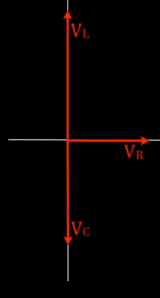

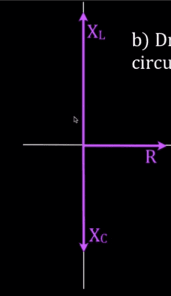

Note: I used -XC because on a graph the capacitor's reactance would be a downward pointing vector. However, no matter if I add or subtract these reactances the final current would be equivalent since 1.59Ω is much, much smaller than 3141.59Ω.
Phasor diagram with a horizontal R axis to the right and a vertical axis: X_L arrow pointing up and X_C arrow pointing down, both in magenta from the origin.
3. I find the current by using the equation of V/Z; however, the issue is that I have two voltage sources-- so which V do I use?
I decided that I could use superposition. So first equation: I = 1.2V / 3140 = .382mA. Second equation: 0.8V / 3140 = .255mA
4. Now I superimpose them. Since the 1.2V source moves rightward and the 0.8V source moves leftward, I did the following:
.382 - .255 = .127mA5. My final result seems to be off. Relative to the voltage through the 1.2V source, here is the graph:

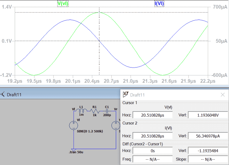

Oscilloscope-style plot of V(Vi) in green and I(Vi) in blue against time from 19.2 to 22.2 microseconds, with cursors marked and a schematic of the RLC circuit below.
As you can see, the difference is 56μA, or about .056mA at the voltage peak of the 1.2V source.
One thing I noticed I did wrong is that the current of .127mA would be present when at the voltage peak of a single source circuit. Since I have 2 voltage sources the way I compared my current to my voltage peak doesn't make sense.
If someone could highlight where I am going wrong I would be very appreciative. The finals are on Wednesday and I've been studying for 6hrs so I'm going to head to bed and check on this in the AM. Thanks :)

Check your capacitor impedance. On the circuit diagram the capacitor's value is specified as 200p. Note the p.
Edit:
Also note that VR is shown to have a (very) small phase difference to VL:
LTspice-style schematic of a series RLC circuit: source VL (SINE(0 1.2 500k)) drives L1 1m, R1 1k and C1 200p in series to source VR (SINE(0 0.8 500k) -250n), with a .tran 50u directive and ground at the bottom left; the phase value -250n is circled in red.
You might want to show that this makes negligible difference to the results.
  • LTspice-style schematic of a series RLC circuit: source VL (SINE(0 1.2 500k)) drives L1 1m, R1 1k and C1 200p in series to source VR (SINE(0 0.8 500k) -250n), with a .tran 50u directive and ground at the bottom left; the phase value -250n is circled in red.
You really can't compare voltages and currents in that fashion. They have different units. What you can do though is find the phase difference. What's the phase angle of the current with respect to the VL voltage source?

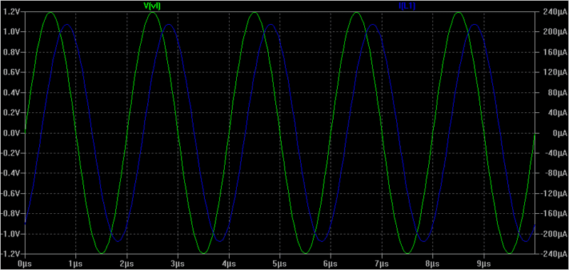

Ahh, which means it leads the voltage, correct?

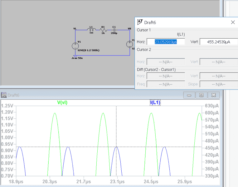

So, what does 217uA represent with regards to a graph? Because when I plot in LTSpice, the peak amplitude is about 450uA.
I'm thinking it is when the voltage is at 0.4V.
gneill said:
At 450 μA the driving voltage is more likely to be VR alone (0.8 V).
Right, but what is the 217uA representing since this is my answer?
That's the magnitude of the current running through the components. The angle is the phase shift (or offset) of the current versus VL's assumed zero phase.
Here's a plot showing VL (green) and I (blue):
Simulation plot of V(vl) in green on the left axis from -1.2V to 1.2V and I(l) in blue on the right axis from -240µA to 240µA, both sinusoidal over 0 to 10µs, with the blue current curve lagging the green voltage curve.
Yeah, probably should have plotted current in red to better show up :oops:
  • Simulation plot of V(vl) in green on the left axis from -1.2V to 1.2V and I(l) in blue on the right axis from -240µA to 240µA, both sinusoidal over 0 to 10µs, with the blue current curve lagging the green voltage curve.

Can you upload your .asc file from LTSpice?
  • LTspice simulation plot with time in microseconds from 0 to 14 on the horizontal axis: green V(vl) voltage trace on the left axis from -1.2V to 1.2V and red I(L1) current trace on the right axis from -250µA to 350µA, both sinusoidal.

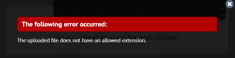

Red error dialog reading "The following error occurred:" followed by "The uploaded file does not have an allowed extension." over a dark background.
When I try I get this error.
However, I haven't changed any settings so everything would be at the stock setup for LTSpice.
  • Red error dialog reading "The following error occurred:" followed by "The uploaded file does not have an allowed extension." over a dark background.
