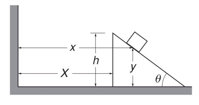

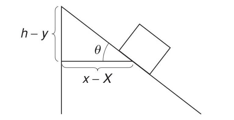

Suppose we want to find the constraint equation relating the acceleration of a block on a wedge to the acceleration of the wedge (see attached images). We can write:
$$h - y = (x - X) \tan{\theta}$$
What if ##X## was measured to the centre of mass of the wedge for instance? Wouldn't the correct equation be:
$$h - y = (X - x) \tan{\theta}$$
I see how you got this and it makes sense.
I do not see how you got that. You still need the sides of the same triangle, you've just redefined what X is. So you need to rewrite your first equation using your new X. For example, if ## X_{cm} = X + a##, then your formula would become ##h - y = (x - X_{cm} + a) \tan{\theta}##.
Doc Al said:
I see how you got this and it makes sense.I do not see how you got that. You still need the sides of the same triangle, you've just redefined what X is. So you need to rewrite your first equation using your new X. For example, if ## X_{cm} = X + a##, then your formula would become ##h - y = (x - X_{cm} + a) \tan{\theta}##.
I just realized the error in my reasoning. This makes sense now. Since ##X## and ##X_{cm}## differ by a constant, their second derivatives should be equal. We chose ##X## to be the distance to the edge of the wedge to simplify the trigonometry required, right?
We chose XX to be the distance to the edge of the wedge to simplify the trigonometry required, right?
Right.
