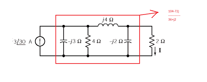

V=IR
First I combined the -j3 capacitor and 4ohm resistor to get:
[tex]\frac{32-j48}{25}[/tex].
Then I combined that with the j4 ohm inductor to get:
[tex]\frac{32+j52}{25}[/tex].
Then I combined that with the -j2 ohm capacitor to get:
[tex]\frac{104-72j}{36+j2}[/tex]

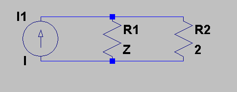

My circuit now looks something like:

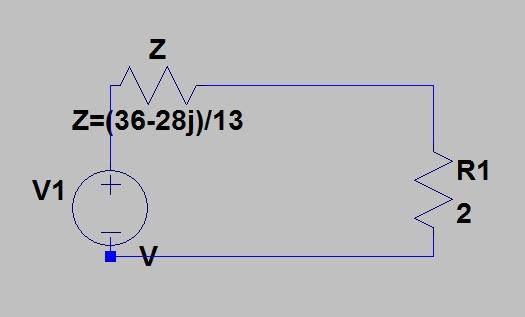

I then transform the Current Source into a voltage source:
3<30° -> [tex]\frac{3\sqrt{3}}{2} + 1.5i[/tex]
Z total = [tex]\frac{36-28j}{13}[/tex]
V=I * Z = [tex]\frac{84+103\sqrt3}{26} + \frac{54-84sqrt3j}{26}[/tex]
I now have something like this:
Have I been doing everything right so far? How do I find I?
You might want to check that result.
As you "absorb" components you must modify the source value, too. Effectively you are converting between current and voltage sources as you progress, doing a Norton → Thevenin → Norton shuffle.
The two steps in red are where you made your mistake. You must combine the j4 and -j2 in series, and then that equivalent combines in parallel with what you have up to that point.

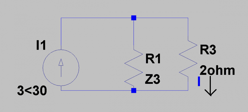

this is what my circuit looks like now, with Z3 = (96-72j)/(36+2j)
Everything good?
how do I solve for current I

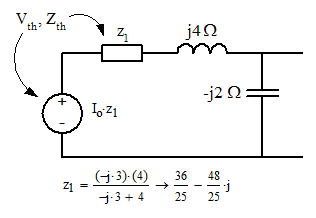

Not good. Your current source has to evolve as you absorb the components. Think of it as taking successive Thevenin or Norton equivalents as you go.
You started by reducing the -j3 capacitor and 4 Ohm resistor to a single impedance, then took it and the current source as a Norton model. All good so far. Then you wanted to absorb the j4 inductor. To do that you have to convert the Norton circuit into its Thevenin equivalent first. So the Norton impedance becomes the series impedance for the Thevenin model and you also have to convert the current source to a Thevenin voltage by multiplying it by that impedance. Then you can include the j4 inductor. The same thing goes for absorbing the -j2 capacitor. You need to convert your new Thevenin model back to a Norton model (source current and parallel impedance). The original current source will be "buried" behind a set of multipliers that it accumulates during the switching back and forth between model types.
Your first change of source goes like this:

I don't believe so, no. In that configuration your Z should match my final Thevenin impedance and it doesn't.
Your Z:
Mine:
Your Z:
Mine:
So your Z is 2.769 - 2.154j at the point in my picture?
That would be my understanding, yes.
