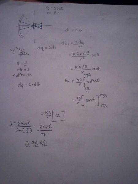

The discussion focuses on calculating the electric field at the center of a circular arc with a uniform charge distribution of 25nC over a 90-degree angle and a radius of 2.0 m. The relevant formula used is E = k*Q/r^2, where k is Coulomb's constant. Participants clarify that the limits of integration for the electric field calculation should be set from -π/4 to π/4, and suggest using symmetry to simplify the algebra involved in the solution.
