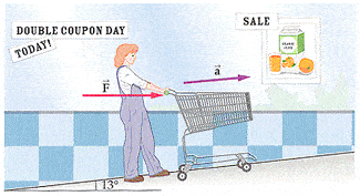

A shopper pushes a 7.3 kg shopping cart up a 13° incline, as shown in Figure 5-21. Find the horizontal force, F, needed to give the cart an acceleration of 1.63 m/s2.
ok, here is the formula to find horizontal force:
sum Fx= F1x +F2x = F1 + F2cos(theta), which also =mAx
if there are no forces given, how do i calculate F2cos(13degrees) and F2sin(13degrees)?
You would leave your answer in terms of the given symbols.
my answer is supposed to be in Newtons, but my question is how to calculate acceleration in the x direction??
Duh, I didn't read the problem statement very carefully. :-p Yes, you will get an answer in Newtons.
Instead of resorting to a canned formula, you should draw a free body diagram and write down equations for the sum of the forces in the x and y directions. You've got the normal force, the applied force, and gravity.
ok so normal force = mass of cart x acceleration of gravity: F=(7.3kg)(9.81 m/s2) = 71.613N, what's the applied force?
No, because the cart is on an incline.
whats the applied force?
That's the unknown.
