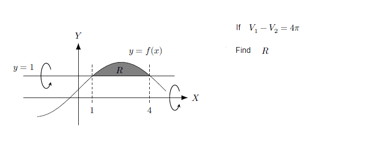

Find the area by using disk method
4 replies · 1K views · last reply
jaychay
58
Diagram of curve y = f(x) rising and falling between x = 1 and x = 4, with the region R shaded between the curve and the line y = 1. Right side reads: If V1 - V2 = 4π, Find R.
The problem is to solve for the area R.
Can you please help me ?
I have tried to do it many times.
Thank you in advice.
$\displaystyle V_1 - V_2 = \pi \int_1^4 [f(x)]^2 \, dx - \pi \int_1^4 [f(x)-1]^2 \, dx = 4\pi$
$\displaystyle \int_1^4 [f(x)]^2 \, dx - \int_1^4 [f(x)]^2 - 2f(x) + 1 \, dx = 4$
$\displaystyle \cancel{\int_1^4 [f(x)]^2 \, dx} - \cancel{\int_1^4 [f(x)]^2 \, dx} + \int_1^4 2f(x) - 1 \, dx = 4$
note $\displaystyle \int_1^4 f(x) \, dx = R + 3$
can you finish?

Equation: V1 - V2 = π ∫ from 1 to 4 of [f(x)]² dx - π ∫ from 1 to 4 of [f(x) - 1]² dx = 4π
Can you explain to me please where did (f(x)-1)^2 come from ? and why you have to put -1 behind f(x) ?
jaychay said:
https://www.physicsforums.com/attachments/10787
rotating R about the line y = 1 using disks ... what is the radius of a disk in this case?
