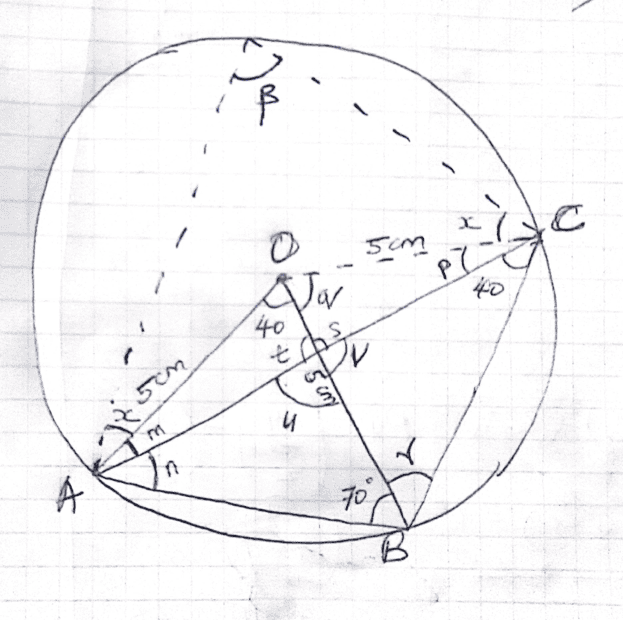

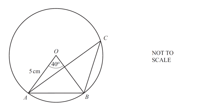

This is my own question. I just made some extension to original question( see diagram)
understanding of circle properties.
My challenge was on trying to determine the angles: My approach;
came up with a number of equations: ie
##m+n=70^0##
##r=p+40^0##
##q-2r=100^0, ⇒ r=50^0 + \dfrac{1}{2} q##
then it follows that,
##2q+100^0=180^0##
##⇒q=40^0, r=70^0, p=m=30^0, n=40^0##
##m+40^0+t=180^0, ⇒t=110^0##
and
##q+p+s=180^0##
##40+30+s=180^0, s=110^0##
problem here...i will need to check on this...
I need to have ##t+s=180^0##.
I know once i am certain on the angles then finding area is as easy as abc...
i see my own mistake...i will go through this again...I may need to use cosine rule...coming back in a moment.

It looks like you failed to provide enough information.
Nothing in the problem description limits C to a single location.
As already noted by @SammyS and @Frabjous, the position of point C on the circle needs to be defined (unless maybe AC and OB are meant to be perpendicular?).
Your hand-drawn Post #1 diagram is wrong. ∠ACB is not 40º.
∠ACB is the angle subtended by AB at a point C on the circumference.
∠AOB is the angle subtended by AB at the centre.
There is a simple relation between these two angles but they are not equal.

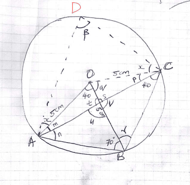

...I realised that the question has many unknowns...been looking at it for last 30 minutes...it cannot be solved...and true ##C## can lie at any point on the circle circumference.
...supposing we are told that the length AD = DC... so that we have the point C fixed at a point. Are we going to have some breakthrough? i need to analyse this later...
While you added a condition, you also added a new unknown. While for a given D, C is determined, D is not limited to a single point.
You are too eager to jump into the analysis, instead of sitting back and developing a strategy.
The equations that i had last were:
##2r+q=180^0##
##4x-q=40^0##
As pointed out by @Steve4Physics "∠ACB is not 40º".
It is 40^0 check on the circle properties... angles subtended by the same chord....
aaaargh its ##20^0## ...you are correct.
