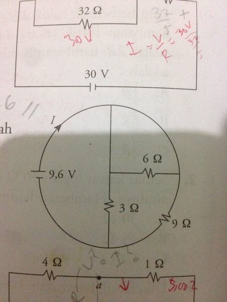

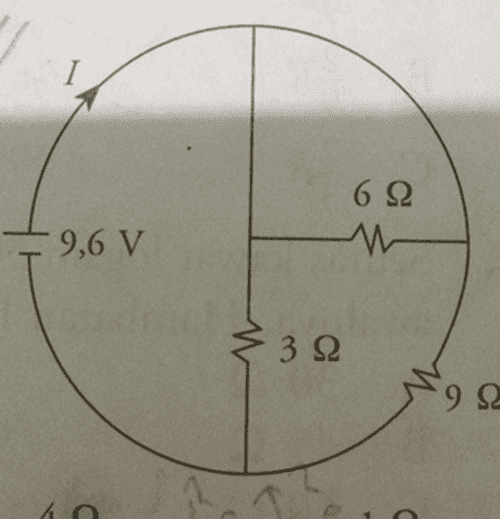

Find the current I in this electrical circuit
52 replies · 6K views · last reply
Helly123
581
Circuit schematic of a loop with a 9.6 V battery labelled I on the left branch, a 3 Ω resistor and a 6 Ω resistor in a middle branch, and a 9 Ω resistor on the right, with 4 Ω and 1 Ω resistors on a lower wire.
V = I.R
6 ohm and 3 ohm are series = b
Then b pararel to 9ohm = c = total resistance
b = 9ohm
c = 9/2 ohm
I = V/R
I = 9.6/c
I = 2,13 A
Can you help me?
Is it right? My friend's answer is 0,8

If you leave out the 3 and 6 the current is already more than 1 A, so your friend must be wrong :smile:

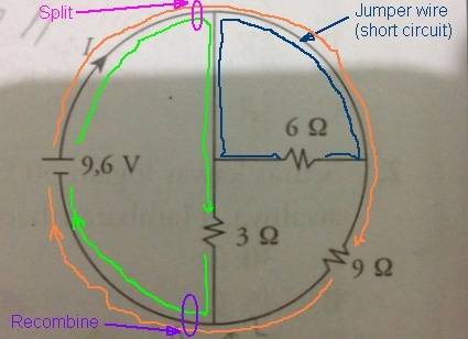

What about the wire from the top to the 3 ohm ? Wouldn't the current prefer to through that instead of through the 6 ohm ?
( leaving out the 6 and 9 leaves only the 3 ! )
They are not.
Can you see anything special about the 6 ohm resistor?

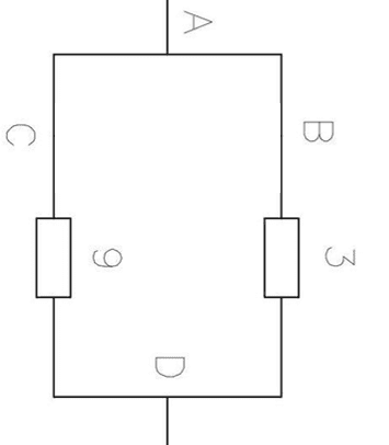

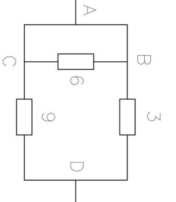

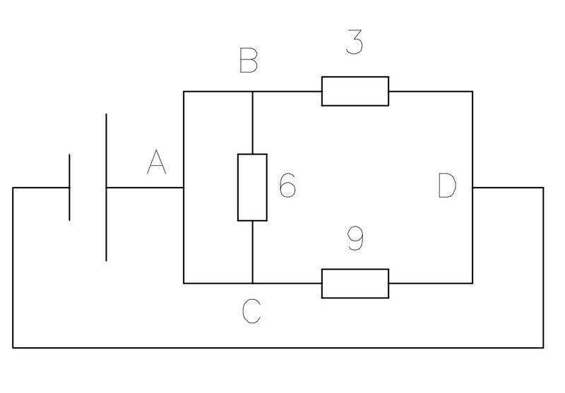

What normally works for me is to re-draw the circuit (e.g. in the drawing I attached). Maybe now you can see what cnh1995 meant with "special" on the 6Ω-resistance?

How far are you now ? Can you see the 6 ohm is short-circuited ? There is a wire from one end to the other. That wire makes the potential at both ends equal -- no current through the resistor. You can leave it out of the diagram without anything changeing. Then things look simple again ...

3ohm and 9ohm are parallel, the total resistance is 9/4
I = 9.6 / (9/4)
I = 4.2 A is it?

What is the potential difference across the six ohm resistor. Under what circumstances can you remove the six ohm resistor from the circuit

That would be the 3.2 we had already plus 1 A for the 9 ##\Omega## resistor ? But how much is 9.6 V / 9 ##\Omega## ?

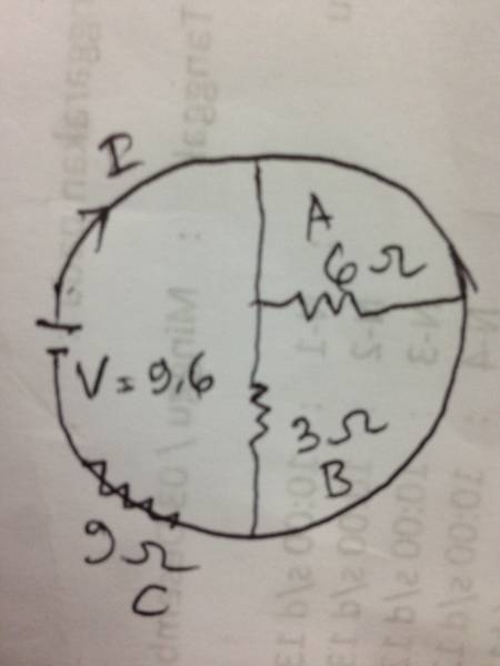

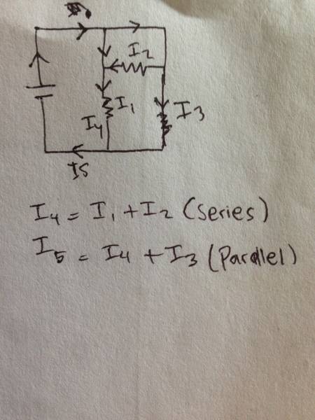

I think that
Handwritten circuit diagram with a battery on the left, resistors labelled with currents I1, I2, I3, I4 and I5, and two equations below: I4 = I1 + I2 (Series) and I5 = I4 + I3 (Parallel).
R series = 6 + 3 = 9ohm (I3)
R parallel = 1/9 + 1/9 = 2/9 ohm
R total = 9/2 ohm (I5)
I = V/R = 9.6 / (4.5) = 2.1A
Close to options 2A ? But I am not sure
  • Handwritten circuit diagram with a battery on the left, resistors labelled with currents I1, I2, I3, I4 and I5, and two equations below: I4 = I1 + I2 (Series) and I5 = I4 + I3 (Parallel).
Options are simply wrong. But from a number of posts in this thread o:) you can conclude that teacher isn't the only one in error :wink:
Perhaps you can see for yourself if you first erase the I and then add some V in your picture: both ends of R2 (the 6 ##\Omega) see the same V so I2 = 0 !
And then your I5 remains standing as correct and easy to calculate !

Since you have the voltage (9.6V) across the 3 ohm and 9 ohm resistor the current through each is:
I1 = 9.6 V / 9 ohm = 1.07 A
I2 = 9.6 V / 3 ohm = 3.20 A
This gives a total current:
I = I1 + I2 = 4.27 A

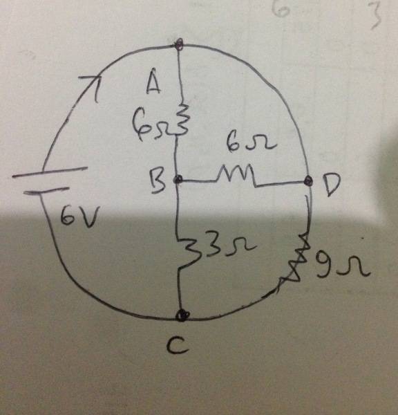

Hand-drawn circuit schematic: a 6V battery on the left of a loop with nodes A, B, C and D, resistors 6Ω (between A and B), 6Ω (between B and D), 33Ω (between B and C) and 9Ω (between D and C).
For this matter, what everyone think, that BD is short circuit or not?
  • Hand-drawn circuit schematic: a 6V battery on the left of a loop with nodes A, B, C and D, resistors 6Ω (between A and B), 6Ω (between B and D), 33Ω (between B and C) and 9Ω (between D and C).
Helly123 said:
View attachment 216507 For this matter, what everyone think, that BD is short circuit or not?
This circuit isn't the one stated in the problem? But in the original problem, yes, the 6 ohm resistor is clearly shorted!

If there is a wire path that you can follow from B to D that does not pass through any components, then you can say that B and D belong to the same node (giving you your "short circuit"). If no such path exists, then B and D belong to separate nodes, and there is no "short circuit".
