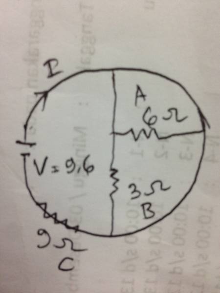

Find the current I in this electrical circuit

If the 3 ohm and 9 ohm were series, then we found the answer 0,8 A which is on the options... so the 3 ohm and 9 ohm not series but parallel?
You can see that they are en parallel, since both of the resistor terminals (of the 3 and 9 ohm resistors) share the same nodes.
If there's no option for giving around 4.27 A as an answer, there is a mistake in the options.

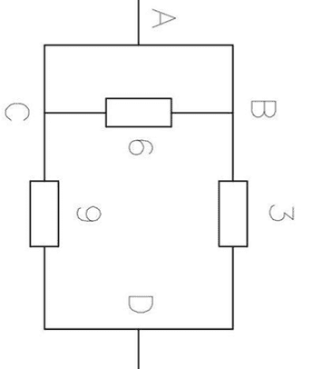

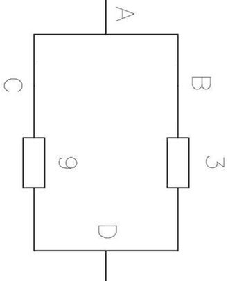

This one
Circuit schematic drawn as a circle: a 9,6 V battery on the left with current I shown on the top-left arc, a vertical wire from the top to the bottom with a 3 Ω resistor, a horizontal branch with a 6 Ω resistor on the right, and a 9 Ω resistor on the lower-right arc.
equals
Circuit schematic with terminals A at top and D at bottom, joined by a rectangular network: a resistor labelled 6 between nodes C and B, a resistor labelled 9 on the left branch and a resistor labelled 3 on the right branch.
equals
Circuit schematic with terminals A at top and D at bottom, nodes B and C joined by a horizontal wire, a resistor labelled 6 between C and B, resistor labelled 9 on the left branch and resistor labelled 3 on the right branch.
Which for some unspecified reason still shows a resistor between B and C in the post but not in the picture attached (below riight) ?:)
Obviously parallel , right ?

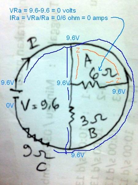

Thanks guys. How about this?
Hand-drawn circuit diagram: a circular loop with a battery marked V = 9.6 V on the left, a 9 Ω resistor labelled C at the lower left, a 3 Ω resistor labelled B on the vertical wire, and a 6 Ω resistor labelled A on the horizontal wire, with current I shown on the upper left.
Is the 6o hm (A) short circuit (jumper wire)?

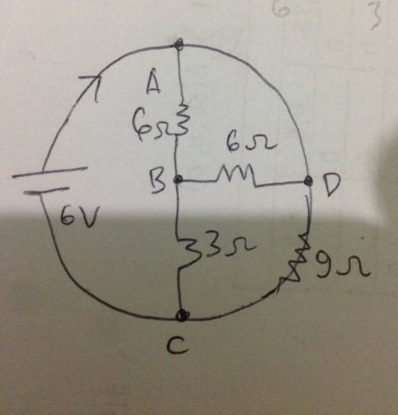

Circuit schematic with a 6V battery on the left and nodes A, B, C and D around a loop. Branches: 6 ohm between A and B, 6 ohm between B and D, 33 ohm between B and C, and 9 ohm between D and C.
Is the BD short circuit (jumper wire)?

Helly123 said:
Thanks guys. How about this? View attachment 216636
Can you draw a line from B to D without going through any components?
I suppose, i can not, it goes through AB. Isnt it?
Yes, so it is not shorted.
Let's ask this in another way. Is the voltage the same at both sides of the resistor?
Start at the positive battery terminal, and trace the circuit with your finger ...
Label the 6 ohm resistor "RA", one side of the resistor Z, and the other side Z'.
What is the voltage at Z?
9.6 volts.
And at Z'?
Also, 9.6 volts.
Hand-drawn circuit diagram: a 9.6 V battery in a loop with a 6 ohm resistor labelled A, a 3 ohm resistor labelled B and a 9 ohm resistor labelled C; a wire links the two sides of A, with voltage labels 9.6V and 0V and handwritten working in blue at top.
What does Ohm's law tell us? If the voltage is the same at both sides of the resistor (that is, voltage drop across the resistor is zero) then IRA=VRA/RA = 0 volts/6 ohms = 0 amps.
In effect, 6 ohm resistor RA is shorted by the "wire" between point Z and Z'.
In this drawing it's the same for connections between RA and RB. The only component with a voltage drop across it is the 9 ohm resistor RC.
Let's re-state the problem in yet another way.
RA is a 6 ohm resistor in parallel with a 0 ohm wire between point Z and Z'.
The general rule is that total resistance for two resistors in parallel is less than the smaller resistor. In this special case the smaller resistor is 0 ohms, and limits total resistance to 0 ohms.
So both A and B are short circuit, because the voltage stream in left side and right side are zero. I see.
