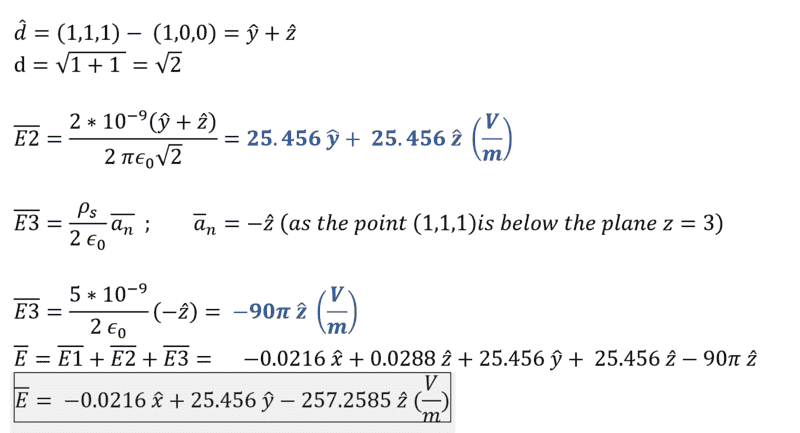

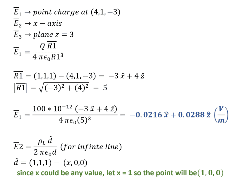

Question:
My attempt:
Could someone please confirm my answer?
In my opinion E2=2*10^-9*(1/√2ŷ+1/√2ž)/(2πεo√2).
Otherwise everything is correct
So d^ is a unit vector, right?
Yes
