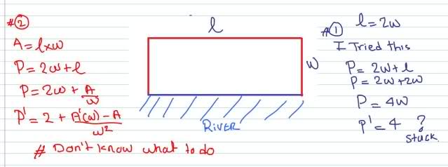

A rectangular field to contain a given area is fenced off, along a stright river. if no fencing is required along the river, show that the lest amount of fencing will be required when the length of the field is twice its width.

i really don't get how to solve this,
my attempt:
Please help
You want to maximize the Area, not the Perimeter !
but they said they want to minimize the fencing.
even if i did A=lXW, i would end up with A=2w2
if i derive it i get A'=4W, and W=0; ?? i don't get it sorry.
@Sammy : The area is given, isn't it?? Why would he want to maximize the area? He has to use the given relation for the area, put it in the perimeter relation and then differentiate it with respect to either length or breadth...find stationary points(where d/dl or d/db is 0) and then use a double differential test to check for maxima or minima.
Also, note how one side will not be fenced. That means a little change in the perimeter relation.
That means something like P = L + 2B and A = L * B. Put A in P to get P = L + 2A/L where A is constant. Find dP/dL and proceed as I said.
so if do it like this:
but i still don't get it, are we not using the fact l=2w, if we did here i would get w=(Ao/(2))1/2
then it doesn't make any sense

Yes, I suppose that's correct.
Then A is constant, so A' = 0.
Then P' = 2-(A/W2).
but P' = 0 at min.
0 = 2-(A/W2).
Solve for W.
This does work out!
