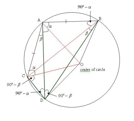

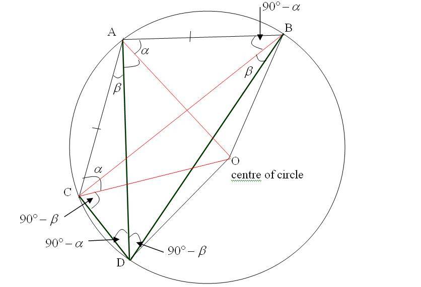

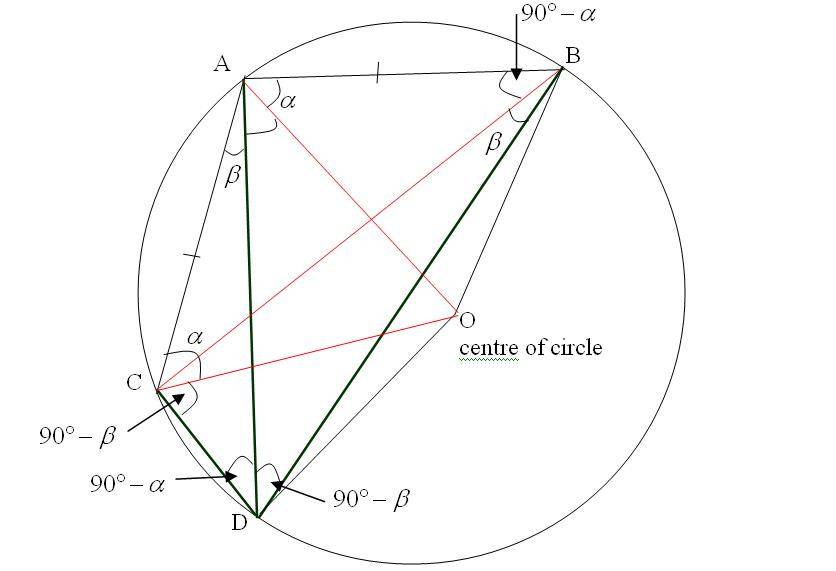

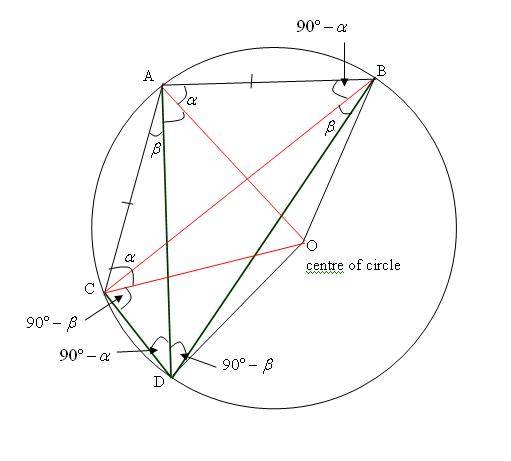

To be honest, I must confess to you that the value of R that I obtained was $$\frac{1250}{3}$$...
The time when I first saw your solution, I became very suspicious of my own result and I checked my working and found out I had made a premature assumption in my solution to which I didn't know how to make it right. I even thought to draw the circle out on a graph paper with the data that I obtained but I didn't do so at last. I told my boyfriend about this and he said I should ask for clarification if I was in doubt. But I thought to myself, 'Hey, Opalg is always right'...thus, it must be best to remain silent in this instance.:o
Having said this, here is my flaw solution and my mistake was by making false assumption that the center of the circle lies outside the cyclic quadrilateral ABDC and now, I even didn't sure if it was okay to label D in between B and C or should I make it lies between the points A and C...I must have thoroughly messed up the problem.
First, I let the the distances of DC, DA, and DB be a, 5a and 7a respectively with a is a positive real value.
By applying Cosine Rule to the triangle ACD, we have:
$$500^2=a^2+(5a)^2-2(a)(5a) \cos (90^{\circ}-\alpha)$$
$$a^2(26-10 \sin \alpha) =500^2$$ (1)
We do the same to the triangle ABD and obtained:
$$500^2=(5a)^2+(7a)^2-2(5a)(7a) \cos (90^{\circ}-\alpha)$$
$$a^2(74-70 \sin \alpha) =500^2$$ (2)
Solving the equations 1 and 2 for $$\sin \alpha$$ yields
$$\sin \alpha = 0.8$$
Hence, $$a^2=\frac{125000}{9}$$ or $$a=\frac{250\sqrt{2}}{3}$$.
Last, by using the Cosine Rule again to the triangle OAB, we find that
$$R^2=R^2+500^2-2(R)(500)\cos \alpha$$
or
$$R=\frac{1250}{3}$$.
You certainly have not messed up on the problem. I think that the question of whether the points come in the order ABCD or ABDC as you go round the circle is absolutely critical. If they come in the order ABDC then that would correspond (in my solution) to the case where $x^2 = 18$, in which case I agree with your answer $R=1250/3$. I assumed that the order would be ABCD, in which case $x^2 = 32$ and $R = 1250/4$.
