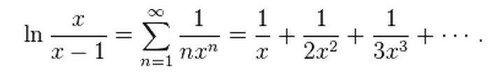

Find the sum of $$\sum_{n=1}^{\infty}\frac{1}{n2^{n}}$$
I tried manipulating it to match one of the Important Maclaurin Series and estimate the sum in that fashion but I cannot see to get it to match any.
I was thinking of using $$\sum_{n=1}^{\infty}\frac{\left (\frac{1}{2} \right )^{n}}{n}$$ with the $$\ln\left({1+x}\right)$$ but that only works if its a alternating series.
RLBrown said:
ln(2)
How did you come to that answer though?
updated w/ref.
