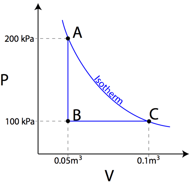

Find the work done on a monoatomic gas in this P-V diagram

internal change = $$\frac{3}{2}n.R.(T2 - T1)$$
Work = P.ΔV
1) T2 = $$\frac {P2. V2 . T1 }{P1 . V1} = 1.2 * 10^3$$
2) Q = Internal change =
$$\frac{3}{2}n.R.(T2 - T1) $$
$$ = \frac{3}{2} * 1 *8.3*10^{-3}*(12*10^2 - 3*10^2) $$
$$ = 112.05 J $$ (the answer is 9*10^2)
3) work BC = the are of triangle ABC = $$9*10^2 $$ (the answer is 1.5*10^3)
4) Heat released is it the same as Heat final - Heat initial ?
Why did you set ##n=1\ \mathrm{mol}##?
The total work done by the cycle is the area subtended by the cycle. You are asked only for the work for the BC leg of the cycle.
No. You get the heat released by considering the change in internal energy and the work done.

do you mean the length BC? work = P.ΔV = which P to be used?
Q = ΔU + W

Is it compatible with the conditions at point A?
As P is a function of V, you have to integrate.
Helly123 said:
Q = ΔU + W
Would that be the heat released?
is the function P = 5-V
how to find P as function of V ?
heat released Q < 0 ; W < 0
-Q = ΔU - W
P is a linear function of V, so P = a + bV. Use the values of P and V at point A and B to find the constants a and b.

Be careful here. If Q is the energy of the system, then Q = ΔU - W, as you wrote previously. The energy released is -Q = -ΔU + W
$$\int_{1}^{4} 5v - \frac{v^2}{2} $$ = 7.5 (wrong answer)
You're skipping some steps. First write P as a function V.
Second, are are using incorrect values. For instance, the volume is never 1 or 4.

Lets take it one step back. What are the values of P and V at points A and B?
DrClaude said:
Are the units of the left-hand side of the equation the same as those on the right-hand side?
point A, when P = 1, V = 1
while point B, when P = 4, V = 1
point C, P = 1, V = 4
This is not correct. Look carefully at the diagram. In any case, you should report values that have units.

We're going in circles. You should really take a step back.
In the integral you just wrote, you put the limits of integration of the volume to 1 and 4. It makes no sense to write ##V=1## or ##V=4##. What units would that be? Hint: the volume is never 4 m3 or 4 cm3 or 4 l or 4

You are taking ##T## out of the integral. Is it constant?

Concerning the volume, this is better, but I think you should keep it more symbolic, and introduce numerical values later. It is better to use
W = \int_{V_i}^{V_f} P dV
or at least
W = \int_{V_0}^{4 V_0} P dV
Helly123 said:
T is constant right..
No. An isotherm in a PV diagram is definitely not a straight line. (Simple check: use the ideal gas law to calculate the temperature at points B and C).
You need to find the equation for P:
P = a +b V

$$ \frac{4P*V}{T1} = \frac{P*4V}{T2}
T1 = T2 $$
P = a +b V
10^5 = a + b(8)
4*10^5 = a + b(2)
10^5 = 4*10^5 - 2b + 8b
-3*10^5 = 6b
b = -5*10^4
a = 5*10^5
P = a +b V
P = 5*10^4 (10 - V)
$$ \int_{Vi}^{Vf} 5*10^4 (10 - V) . dV $$
$$ \int_{2}^{8} 5*10^4 (10 - V) . dV $$
$$ 5*10^4 \int_{2}^{8} (10 - V) . dV $$
$$ 5*10^4 * ( 10V - \frac{V^2}{2} |(2)(8) ) $$
$$ 5*10^4 * ( 80 - 20 - (\frac{64}{2} - \frac{4}{2}) )$$
answer is 1.5 * 10^6
the right answer is 1.5 * 10^3
why?

In SI units, V is never 8 or 2.

Take point B, for example: ##V = V_0 = 2 \times 10^{-3} \ \mathrm{m}^3##
Helly123 said:
Why can't we use the $$\int \frac{1}{V} dV $$
You have
W = \int_{V_B}^{V_C} P(V) dV = n R \int_{V_B}^{V_C} \frac{T(V)}{V} dV
where I have explicitly indicated that both P and T depend on V in the BC segment.

How do i know? According to Law $$ \frac{P1V1}{T1} = \frac{P2V2}{T2} $$ T at B and C are the same

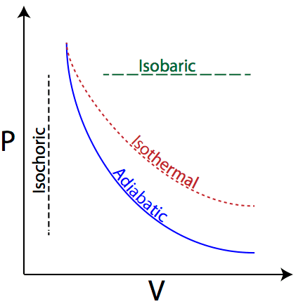

Helly123: What is the formula for the area of a trapezoid? Did you notice from the diagram that the area under the line BC is a trapezoid? What are the actual pressures at B and C, and what are what are the actual volumes at these points?
For the heat removed in step CA, this is a constant pressure process, so $$Q=\Delta H$$. What is ##\Delta H## for this change?

$$\Delta H$$ is $$\Delta U ?$$
$$\Delta U$$ is the same in every segments of diagram.. so, 9*10^2 J.
While the $$W = P\Delta V$$
$$ = 10^5*6*10^{-3} $$
Q = 1.5 * 10^3
