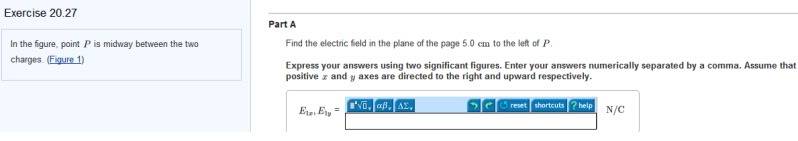

the goal of the problem is to find the x and y component of an electric field.
given distance 2.5*10^-2 m

the diagram was given from my MasteringPhysics assignment.

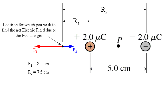

okay based on feedback, i think I have the idea. the electric field in the plane of the page 5.0cm to the left of P is by using the force expression (9*10^9)(2*10^-6)/(2*10^-2)^2 = 4.5 * 10^7 N/C.
i know i am suppose to use trig to find the x and y component but i don't think I have enough clue in the problem to figure out how to approach finding the components. i know the resultant is 4.5*10^7 N/C which the the electric field
http://i33.photobucket.com/albums/d86/warnexus/electricfield.jpg
Since the point of interest lies in the plane of the page, and so do the charges, and since the point and charges are co-linear along the assumed x-axis, what can you say about the y and z components of the field at the point? Remember that the electric field emanating from a point charge is radially directed.
Also, there are TWO charges to deal with here. Both will contribute to the net field.
I was expecting your diagram to end up looking something like this:

R2 = 7.5cm
haruspex said:
R2 = 7.5cm
Heh. I did say "something like this", after all... :blushing:
Edit: Fixed the diagram.

wait based on your diagram left of P is 5 cm. the y component looks smaller in magnitude than the x component from your diagram
What is shown is the directions and rough relative magnitudes) of the field vectors. E1 is due to the +2μC charge, and E2 is due to the -2μC charge. Yes they are different magnitudes! The charges are at different distances. There are no y-components because it is assumed that the charges and point are co-linear along the x-axis and the fields are emitted radially from the charges.
the x component turned out to be -2.6*10^7. man this question is hard. i must have spend 3hrs on this problem alone. physics homework sure consumes a lot of time.
