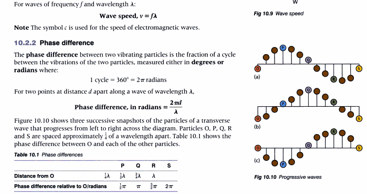

Hi all,
This is not homework or coursework. I am not sure whether this question would be classed as homework or coursework because it is neither.
I am using the AQA Physics A AS textbook and attempting exercise 12.2 on page 177. In I am stuck on question 4 and I have absolutely no idea on how to find the amplitude. I have spent almost a day but still I haven't been able to find a matching answer. I was hoping someone here might help me.
Here is the full question:
For the waves in Figure 4,
a) determine i the amplitude and wavelength, ii the phase difference between P and R, iii the phase difference between P and S.
I can find the phase differences but not the wavelength and amplitude. I am probably missing something or have missed something and I am looking for a hint.
I managed to find a preview of the page here
I managed to get a screenshot of the page:
Thank you.

The amplitude is the distance from the center line to a highest point on the graph. You can't tell from the graph because there is no vertical axis.
Hi,
I think you can by using the table, the phase difference formula and trigonometry. I have tried that but I don't get the right answer.
googl
here are two sketches that illustrates what you are looking for...
If you understand the definition, the concept, I would not waste further time on this silly representation.
http://en.wikipedia.org/wiki/Transverse_wave
good lord...They have managed to take a few simple questions and turn them to a convoluted
interpretation...
What phase difference did you find??
I have no idea how to scale the plots..either vertically or horizontally.
'Distance from 0' as provided in the chart is actually incorrect...what they mean is the 'x' [horizontal distance] from o...
I hope the concepts in the rest of the text are presented more clearly than here!
