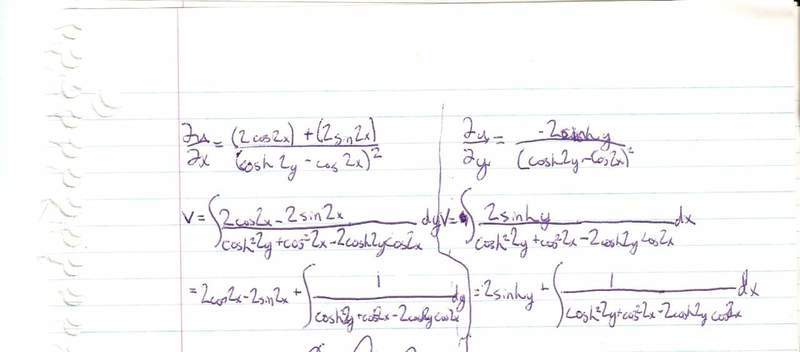

Find a function f(z) that is analytic in a suitable part of the Argand diagram for which
Re(z) = sin(2x)/[cosh(2y)-cos(2x)]
I've taken the derivative with respect to both x and y and am attempting to integrate them to find an imaginary part of the equation that will satisfy the Cauchy-Reimann relation (du/dx = dv/dy; du/dy = -dv/dx where u is Re(z) and v is Im(z)), but I et to an integral I am not sure how to solve. My work is attached in a scanned document.
Thanks for helping!
Andrew
  • Handwritten working on lined paper: partial derivatives of u with respect to x and y, then integrals for v using Cauchy-Riemann relations, with some integrands partly written out.
Your expression for du/dy would be a lot easier to integrate dx if it were correct. Can you fix it?
