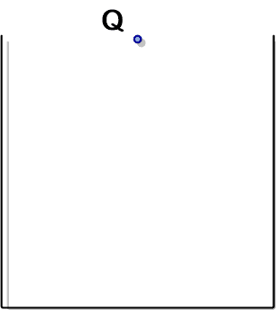

Say you have a hollow cylinder, whose one side is open. Now, you pace a positive charge ##Q## at the centre of this open end (such that it is just inside the cylinder). How much should be the flux coming out from the closed end?
I just thought of this problem. In order to use Gauss' Law, we need a closed surface. Can any such imaginary closed surface be constructed in this case? In short, will any flux be coming out of the closed end?

That is what we call the problem statement in the homework fora. 'nothing more' and 'enclosed' appears misplaced to me. I am curious to find a handle to work out a solution. Does not seem trivial at all to me
Thanks for the diagram, I meant that.

As per the diagram given by @BvU, one side of the cylinder is open. That's where the problem lies.
Why would this matter? You wanted the flux that goes through the other end. The only thing that matters is how far away that surface is, and its surface area.
Zz.
Would the ##\vec E \;## field be distorted by the conducting can in such a way that the flux through the bottom is the same as in the case the can isn't there ?
It would be distorted, because in the case where there isn’t a can the E field is purely radial, but in the case where there is a can the field must be perpendicular to the surface of the can.
If it were a flat box then I would use the method of images, but in this case I would need to numerically solve the electrostatic equations. There might be a more elegant method, but I don’t know it.
