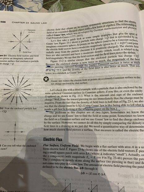

Can you explain:” however we can not do all this by simply comparing the… “ in below image.
Yes, well your book seems to introduce the student to Gauss's law using a "Field line" version of the law, where the charge that is enclosed by a surface is proportional to the number of field lines that pierce the surface. This version of the law is somewhat intuitive or visual I would say.
We need a version of the law that uses mathematical equations to find the enclosed charge ,given the magnitude and direction of the field on the surface, or find the magnitude and direction of the field given the enclosed charge. So just keep reading next section, the electric flux concept is the mathematical way of stating Gauss's law.

Also gauss law is used to simplify the lengthy process of finding the relationship between field and charge for a given Surface. We know the Density of field is proportional to charge. That density is represented by flux and we establish the relationship between density and charge ie gauss law and thus we can find field in easy way of few algebra steps.
