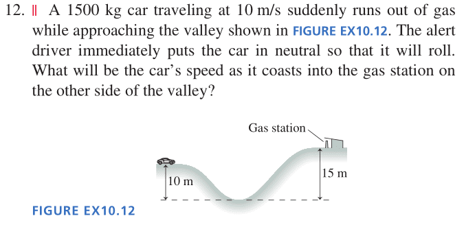

Problem statement and diagram in the photo
K = 1/2 mv^2
U = mgh
E_0 = E1
K_0 + U_0 = K_1 + U_1
using relevant equations and solving for v1 I get:
v_1 = sqrt((v_0)^2 + 2gh_1)
Then E_1 = E_2
solving for the final velocity and the top of the 2nd hill v_2:
v_2 = 1.4 m/s
There is no answer in the back of the book for this problem, just checking to see if my answer is correct, Thanks!
Yes.
