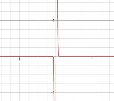

So does this new δ(r) look like a rectangular hyperbola with its value zero at all points except at x=0?
This a graph of ##\frac{e^-{100x^2}}{x}##.
TSny said:
Usually we require the point where the argument is zero to be within the range of integration (rather than at the boundary of the range of integration) in order for the delta function to yield it's full nonzero contribution.
Why can't it be defined such that ##\int_0^R\delta(r)=1##
If you take ##\int_{-a}^R\delta(r)##, it will be zero.(from the graph).
What do you mean by argument of a function?
We are working in cylindrical coordinates (r, θ, z) where r is always greater than or equal to zero.
