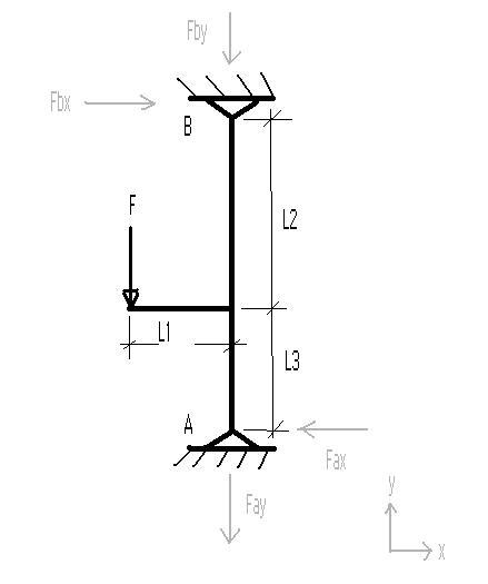

Find the expression for the forces on support A and B. Fax, Fay, Fbx and Fby.
I'm thinking;
Moment , M=F*l
Fa^2=Fax^2+Fay^2, same for b
Fax=Fbx
(1) M = F*L1
Since I know that the sum of moments around the "joint" is zero, and that Fax=Fbx I can find both Fax and Fbx.
What I don't understand is how to find the forces in the y direction. Could someone please give me a hint on how to proceed? Thanks a lot!
You know from Statics that the forces at A and B in the Y direction must sum to F. Since the problem is statically indeterminate, you need another equation to find out how that force F splits between the 2 supports. Think about axial deformations in the member AB under the Load F applied at L3 up from A (Hint: Think about proportioning the load).
I just can't see what other equation is needed. About the axial deformations you mentioned; do you mean hos the rod tries to "pull" support A upwards?
Thank you
No, the force F, applied at the point where the horizontal and vertical members meet, puts the 'squeeze' on part L3, but 'extends' part L2. From compatability, these 2 deformations must be equal. So most of the load goes to the shorter (stiffer) part of AB. For example, if L3 were very short in comparison to the total length of AB, just about all of the load F would go to A.

A statically indeterminate structure is one in which there are more unknown reaction forces (or internal forces) than there are the static equilibrium equations. In this problem, there are 3 static equilibrium equations: Sum of forces in X direction =0, Sum of forces in Y direction =0, and sum of torques (moments) about any point =0. But there are 4 unknown reaction forces, namely, Fax, Fay, Fbx, and Fby. Using the static equilibrium equations, you can solve for Fax and Fbx, but try as you might, you can't solve for Fby or Fay without having to consider compatability and deformations. All that the static equilibrium equation will tell you in the Y direction is that Fay + Fby = F (the applied force); it cannot determine how that force F splits amongst each of those terms. That is why you need another equation beyond those 3 equilibrium equations.
If one of those supports were a roller support instead of a pinned support, that is, it was free to slide vertically, then the problem would be statically determinate, since all of F would have to be taken out at the pinned support. But such is not the case here.
Let's assume in this problem that L2 and L3 are equal. Can you visualize that for this case, The reaction upward at A would be F/2 (placing segment L3 in compression), and the reaction upward at B would be F/2 (placing segment L2 in tension)? Now you have to develop the general relationship when L2 and L3 are not equal, using the deformation approach. Are you familiar with the deformation formula? It is a linear equation, such that you can proportion the vertical load reactions as a function of the segment lengths. The shorter member carries the greater share of the vertical load.

I used Hooks law and found that Fby/Fay = L3/L2. I then use F=Fay+Fby with it and get that
Fay=F/(1+L3/L2)
Is this correct? Thank you
Fay=F/(1+L3/L2)
Yes, excellent. You might want to rearrange terms a bit, to get [tex]F_{ay} = FL2/(L2 + L3)[/tex], but it's just an algebraic manipulation to put it in a somewhat better form. You'll also find that [tex]F_{by} = FL3/(L2 + L3)[/tex].
I assume you've calculated Fax and Fbx correctly?

For Fax and Fbx I just used the fact that the moment about the joint is zero and that Fax=Fbx.
That should be correct.

Fax and Fbx are equal, but they point in opposite directions, as you show on your diagram. Their values are functions of F, L1, L2 and L3. If you are comfortable with your result, fine. I notice, however, that you have not shown the proper direction for the support reactions Fay and Fby. Be sure to catch it.

I think I may have unfortunately left my imagination in Disney World, but regardless, I was envisioning a free body diagram of member AB, where at that joint you have a downward internal force F and an internal counterclockwise couple of (F)(L1). The actual applied force F is where it is. Nice job!
If I envision the member AB with a internal force F which "squeezes" the bottom part and extends the part above the joint I would say the supporting forces Fay and Fby should face in the opposite direction.
The way I saw it was that the force F "twisted" the construction around the joint. That's why I drew the supporting forces as I did.. Hm, I think I'm a little bit confused. Care to explain?

That is correct. Fay points upward (toward the member, compression forces in segment L3), and Fby also points upward (away from the member, tension forces in segment L2). It takes a little imagination to determine this.

You are confusing the axial forces in AB, which causes no twisting, with the moment couple, (F)*(L1), which does the twisting. It is this couple which produces the horizontal reactions Fax and Fbx in the directions you have shown, which, for some reason, you have been very secretive of the values you have determined for same. Care to disclose them? I'd very much like to see what you got.
I think i get it now. I thought you didn't have any imagination :) Thank you very much.
Here is how I find Fax and Fbx:
Moments around the "joint":
F*L1=Fbx*L2+Fax*L3
since Fax=Fbx
Fax=F*L1/(L2+L3)

Yup, you got it! I was just testing you, because sometimes as we focus on the difficult, we mess up the simpler stuff. Also, way back in your original post you noted that Fa^2 = Fax^2 + Fay^2, which is quite correct. But it is perfectly acceptable (and preferred) to leave the support reactions in their x and y component forms. Peace.
