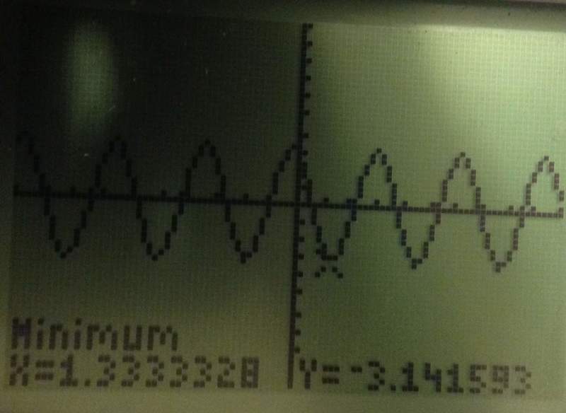

Given that V(t) = π*cos(πt/1.6 + π/6), at which time after t = 0 s is the kinetic energy first at a maximum? The answer is 1.33 seconds. Although, when I put it in the calculator, 1.33s is at a minimum. How would you do this by hand? Step by step work would be appreciated. Thanks!
I was given the position which was x(t) = 1.6 sin(πt/1.6 + π/6) and took the derivative to get V(t) = π*cos(πt/1.6 + π/6). No clue on how to go from there to get to the maximum.

I graphed it but I really want to know how to mathematically determine the maximum or in this case the minimum. Which I think the answer key may of been wrong.
This is the graph of velocity. What is interesting, is the graph of kinetic energy.
What is the expression for the kinetic energy given the equation for velocity you have found?
The kinetic energy is proportional to v2. For your velocity variation, how do the v2 values at the maxima of v compare with the v2 values at the minima of v? Which occurs first after t = 0, a maximum in v or a minimum in v?
