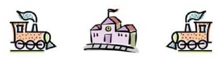

Two trains approach the train station from opposite sides each moving at an initialvelocity of 120 km/h with respect to the station and slowing down to a halt in 20seconds. If both trains are whistling at 5000 Hz, find the distance between the zeroand first order maxima as a function of time.
Three simple clip-art icons in a row: a steam locomotive on the left, a small building with a clock and flag in the middle, and another steam locomotive on the right.
